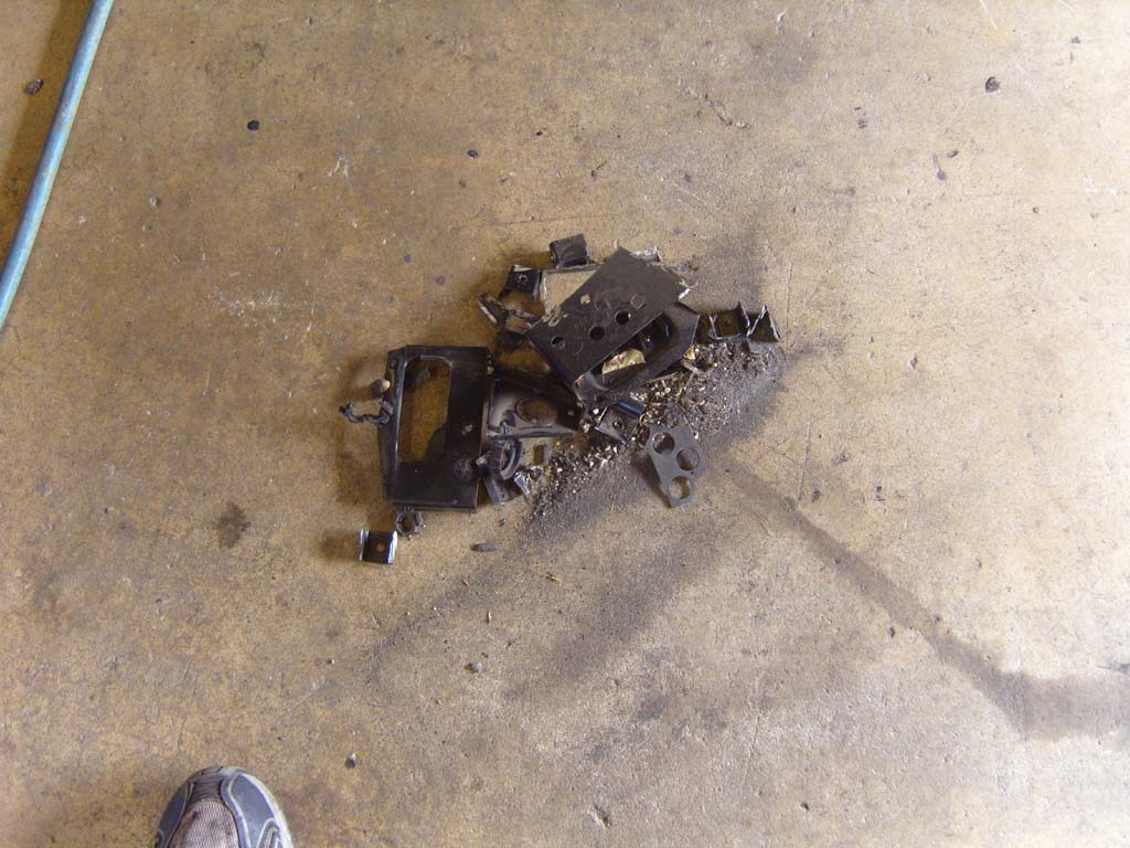

A bunch of miscellaneous braketry was removed from the engine bay:

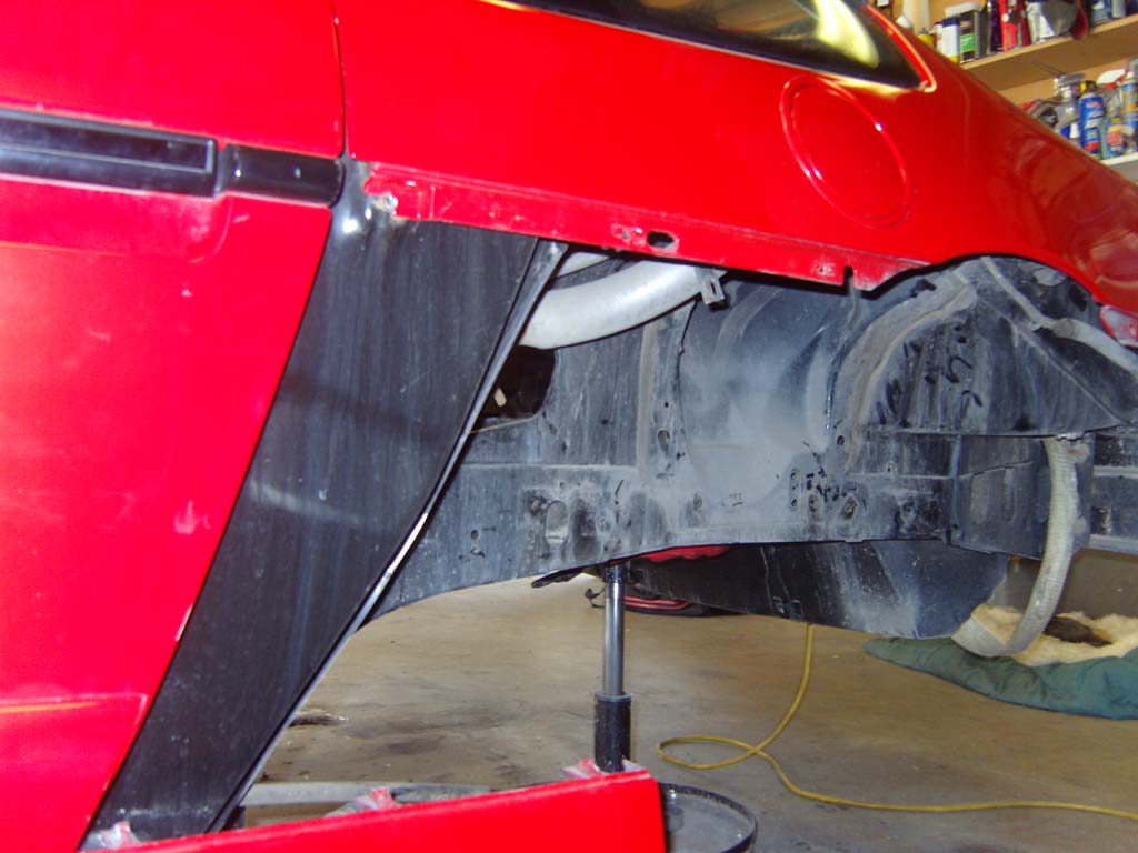

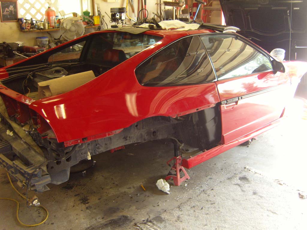

The quarter panels have been removed in preparation for the installation of the scoops:

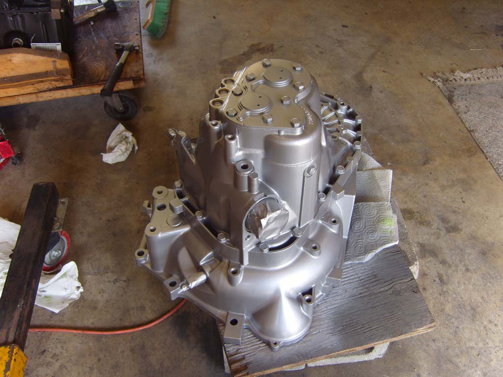

Joe has started painting of the engine bay and the wheel wells and has color matched the paint for the scoops. The powder coating for the red and black pieces should be done by tomorrow. And the tranny has been cleaned and prepped:
