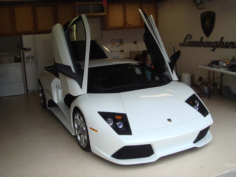

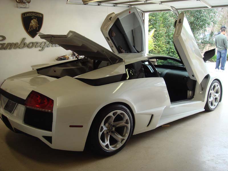

Going to make a little wall art in my garage for my choptop., like this replica guy did, in lamborghini script, on his garage wall.
I think i am going to go with Fiero GT, and or Pontiac in the FIERO FONT.
This is how he told me he made it:
" Its 3/4" MDF plywood covered with stainless steel metal-mica. I used a projector to project the image on the plywood, drew it out, then cut it with a jig-saw. Then I painted it black, and covered the face with a sheet of thin stainless steel veneering (metal-mica). Then I routed the excess off, and it was done. The crest is also 3/4" MDF, covered with a flag/banner that I bought from Ebay for $10[This message has been edited by exoticse (edited 03-29-2009).]
Falcon Fiero
MAR 29, 09:03 PM
THAT is a replica???? Best I have ever seen!

Yes and it is built off a fiero.
This car has everything from custom made, WORKING, paddle shifters that work with the fiero DNA, and working, motorized, bat wings. Yes probably the best murcie replica ever built.
