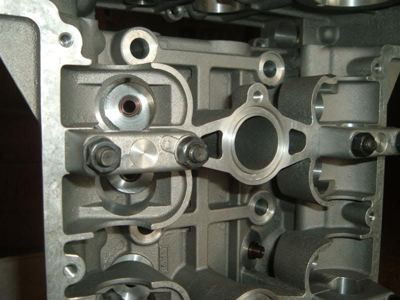

That's what I thought at first too...Unfortunately it's a no-go. Here's a pic of the Vega topside:
And a pic of my topside:
On the SD head, the cam bearing bosses are located in between the valve tappet bores. This is a good thing because it minimizes cam flex by reducing the distance from the load on the cam to the support. On the Vega head, however, the cam bearings are located to either side of a set of valves for a single cylinder. In addition, the Vega motor, as well as other 4cyl Cosworth engines, use belt-driven camshafts, whereas the SD head uses a chain drive.
So the camshafts that I need are actually extremely similar to the Cosworth XB, XD, and XF series of Champ Car engines:
Same bearing arrangement, also chain driven camshafts, it even has the same valve/port angle. but I doubt the bore and valve spacing is the same.

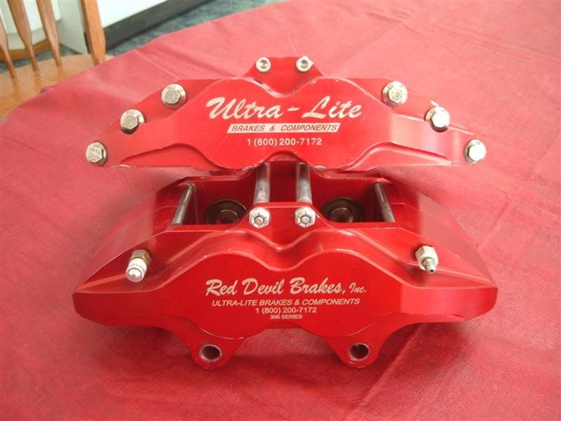

Planning on using some kind of aftermarket radiator. The IC is an air/water Spearco, I think it's on page 5, I'll run that with a full width heat exchanger up front. The stopping is yet to be determined, I have stock rears and the GA upgrade fronts. Right now I'm thinking 13" Wilwood GT rotors and hats with Red Devil 300 Series calipers that I already have for a different project that they were too heavy for.
I begin on suspension and interior improvements after the engine is finished and the car sees the track at least once.
