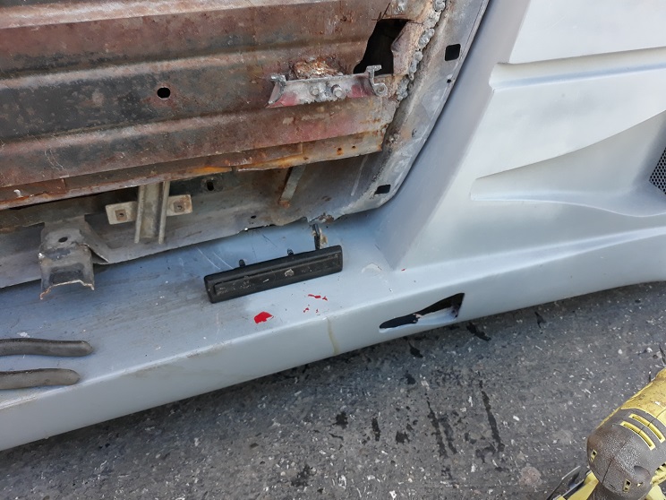

Got the passenger door latch working good w the old lever rod. I liked the way that works better so I did it to the drivers side. Ds outer handle works perfect now. I was running a rod from the latch to the door opener and it kept hitting and rubbing on stuff. Now the rod runs from the latch to the original handle(not fiero original where the builder put em)- and the handle has a cable that runs to the opener. Heres a pic of the door handle I broke and was in the process of replacing w a new one
Now the pass door doesnt wanna open so itll need a new thicker rod. Once those are working perfect, Ill take em to the locksmith n get some keys made. Kinda stuck on dash wiring. Need to run thru the manual again. Cant find the headlight n running light wires, will probably run new wires. Nah more fun hanging out w my kid lol

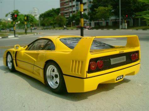

By the way, that thing would look awesome in painted in Ferrari "Fly" Yellow.
