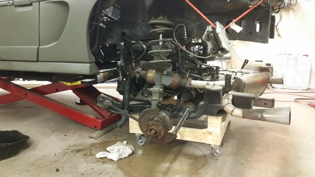

Hard to believe its been 3 years since I completed this swap and I've 3 years of almost trouble free motoring. But a few oil leaks have crept in and the time has come to repair them as well as a few other things. Last fall I purchased a Snap-On mid rise scissor lift in anticipation of this project. Removing the drivetrain from a Fiero with the aid of a lift is almost effortless, I wish I would have had one when I did the swap. I built a cart to hold the complete drivetrain and lifted the car off of it, easy-peasy.
Unfortunately I had a mishap with the lift last fall. The scissor lift has a stationary leg and a leg with rollers that moves toward the center as the lift raises. With the engine in the rear, I should have put the car on the lift with the stationary leg at the rear but I didn't. As I raised the car, the roller leg moved in changing the center of gravity and when the lift reached full height the car and lift tipped over backwards. This caused the nose of the car to crash into the ceiling of my garage, damaging the car and filling the air with sheetrock dust. As the car tipped, it spit the lift out the front and into my garage wall. Luckily I wasn't standing there or it probably would have been bad. The only damage was to the hood and bumper (and my nerves).
This mishap has lead to 2 more projects, sheetmetal and fiberglass repair, and re plasti-dipping my car due to the damage. Think I'm going to use the opportunity to change the color of my car......just not sure to which one. Leaning toward this color:

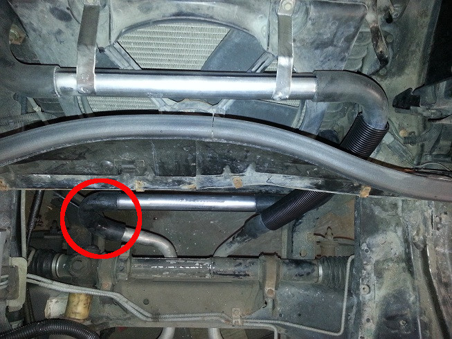

On another note, can you share the part number, or application, of the hose as seen below please? I too have to run a crossover as you did. However, my local Napa store didn't have a very large selection to choose from.
Thanks for your time.
seajai JUN 09, 08:14 AM
PM sent.
I can't find my hose tags I had saved so I don't know what that one was from. I got all my hoses from Oriellies, maybe try them.
Sorry.
