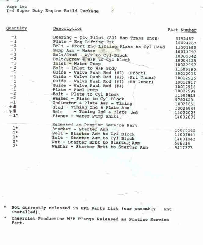

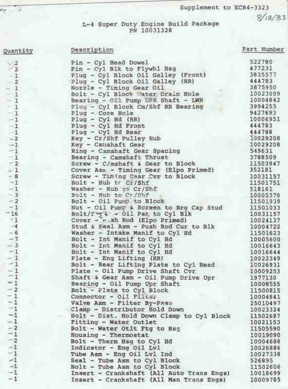

FastIndyFiero MAY 27, 12:55 PM
Here's scans of the original build sheet, hand dated 8/18/83 that sat in my SD Build kit box (10031328) for more than twenty years before I bought it. The original is in very bad condition, with lots of tears, it's almost ripped in half. I'm amazed the scans came out this well!
