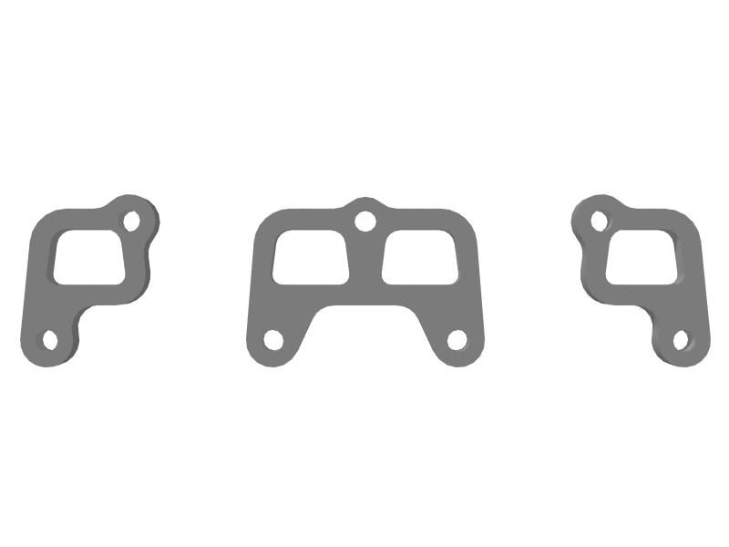

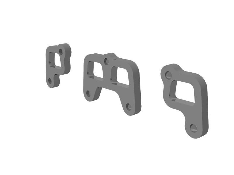

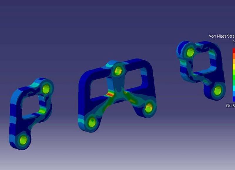

I thought I'd let everyone know my exhaust flanges are designed. This should be final version, I've been looking around at who can machine these from 321 stainless.
One picture of a thermal load being applied:
Soo...there's some major progress being made!

Still haven't heard back from SPD Exhaust, who I called to have the exhaust flange laser cut. I'm not sure what the deal is with that gasket, I've been contemplating O-ringing the ports and making my own gasket.
