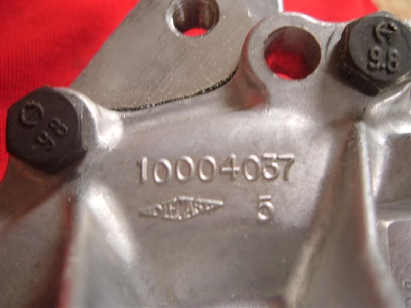

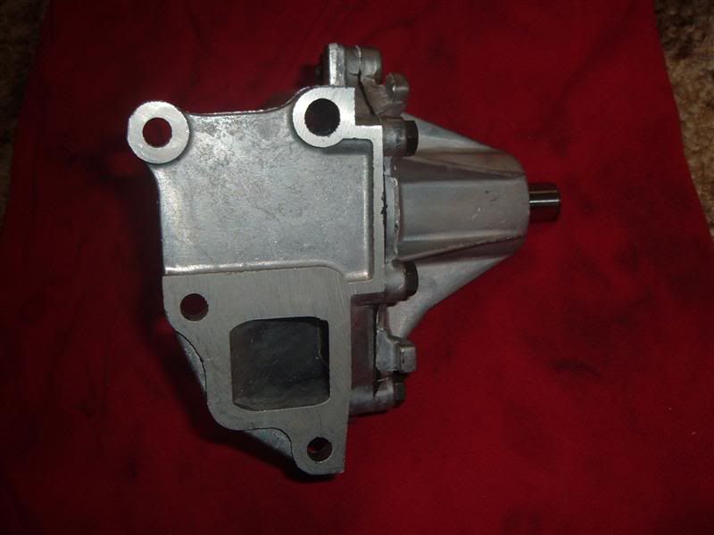

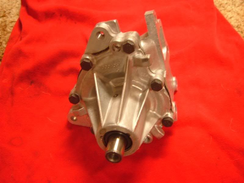

You're the bomb man! I have been researching this pump for about 3 weeks now to no avail. It is shorter than the stock S-10 pump.
Okay...Well. I can't find the master list of all the components that came in the kit. So that REALLY sucks. I've been in cleaning mode for the last couple of days just trying to find some of my documentation. There's two different GM part numbers on the waterpump, but I have a feeling they're just for the case halves of the pump, not the entire unit.

CRAP!!!! Another brick wall on this water pump! Can you send me a really good photo of it that I can take to my parts guy? He is already used to me coming to him with "off the wall" parts. If anyone can find it for me, he is, just need something for him to go by...I hope yours never goes out, I think you would play hell tryin' to find one!

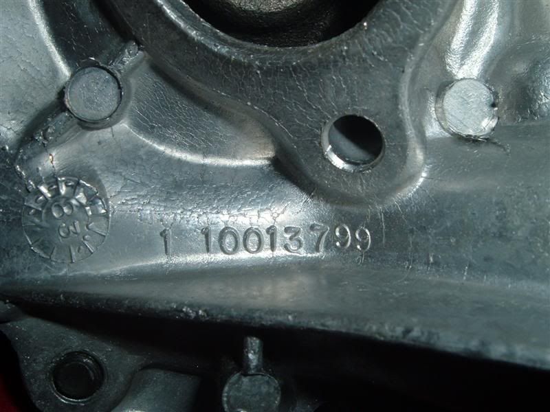

It looks pretty much exactly like the stock pump as far as I can tell. I'll get it side-by-side with the stocker to look for any differences you could look for and get some pics. I'll also post up the #'s from the case halves.

So does the pump bolt to the front of the block, or does it have an adaptor to bolt into the boss in the side of the block?
The pump bolts to the side of the block exactly like the stock waterpump. It looks like the outside housing is exactly the same. I think the only change is likely a larger impeller or passages.

Pics of the torque plate AND water pump info today, I promise!

Bump for those pics...

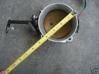

Here's my TB I purchased:
It's a 90mm Accufab TB for a Mustang. A chatter brought up the possibility that the large opening size of this throttle body could have a bad impact on air velocity when it transitions from the intake tube into the TB mouth. I guess I'll see!
Nate
you know a 2.5 id throttle body will give awsum throttle response and easily support 400 hp
in a turbo application right ?
Yes. I just wanted a clean looking throttle body and capability for alot more power down the road.
FastIndyFiero FEB 16, 10:49 PM
As promised except really, really late:
