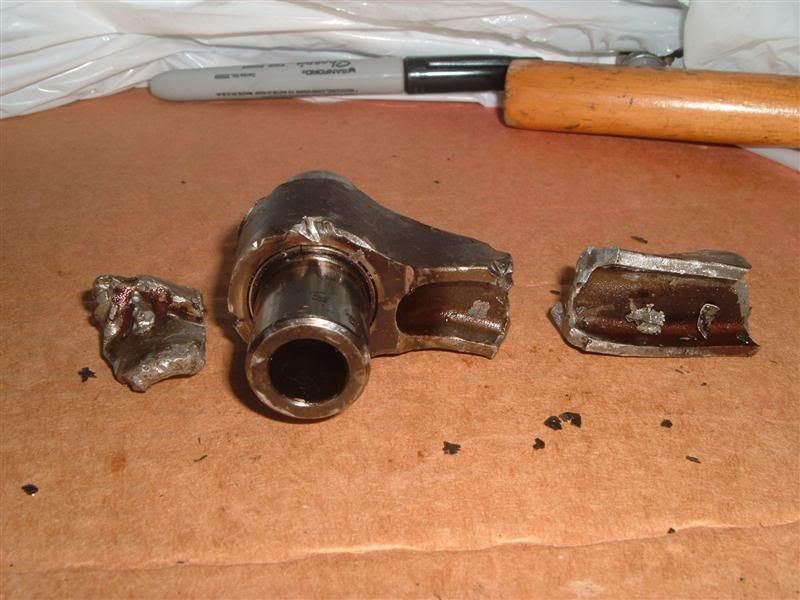

| quote | Originally posted by FastIndyFiero:
No updates right now. I just recovered the pieces of the conn rod from my Sable engine however. Ooops
I'm warning you (again), SELL IT NOW!

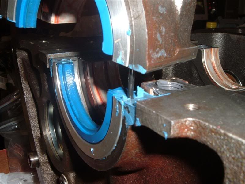

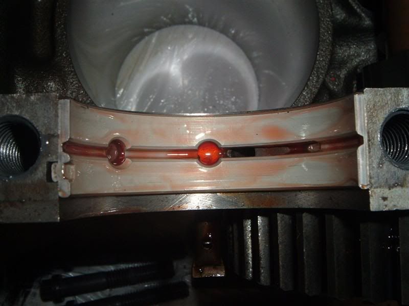

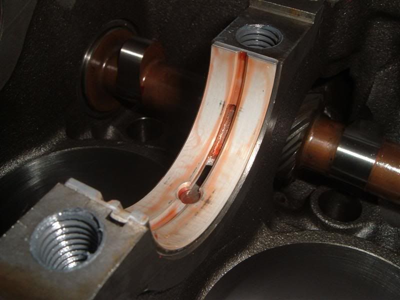

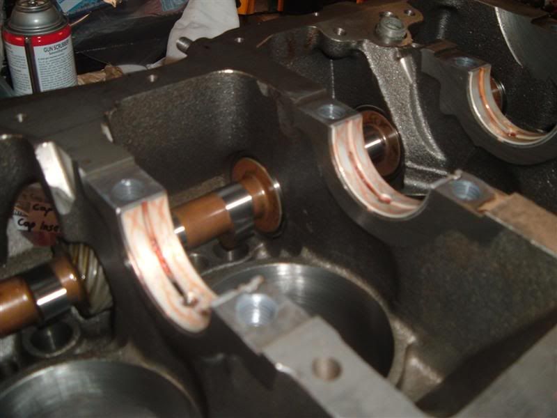

 Tadaa! Yeah, okay. So maybe taking it apart isn't necessarily a step in the forward direction, but those will be coming soon enough. Since the cam and crank have to come out to get the cylinders refinished, I thought it would be a good time to snap some pics of stuff that I wasn't able to document earlier:
 Main bearings...The pic pretty much explains all.

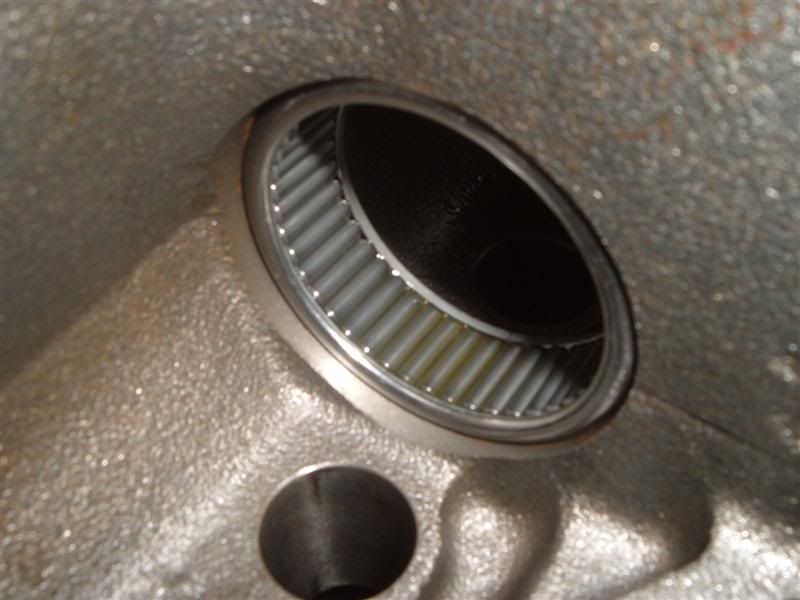

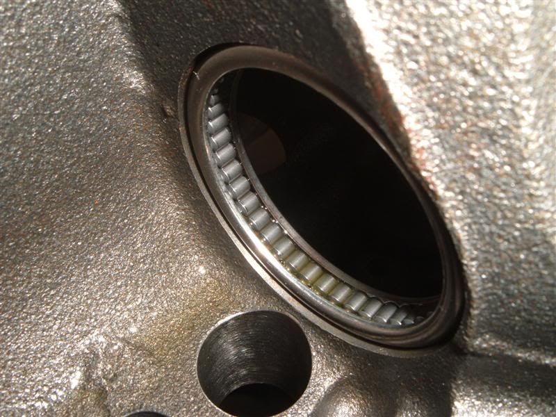

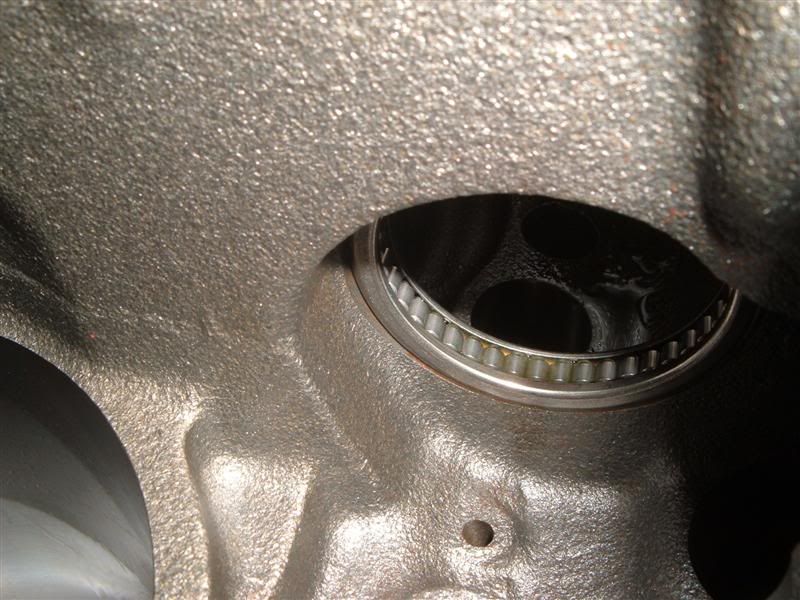

Camshaft: out. I thought I'd snap a couple pics of the SD cam bearings.
This is a good shot of one of the secondary cam journals. Obviously, it's much narrower than the 3 main journals.

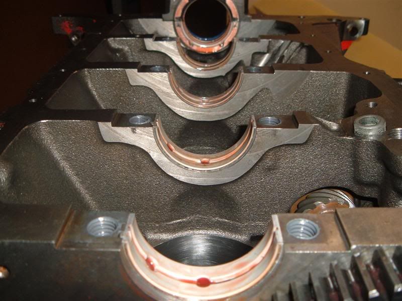

This is a good shot that shows just how much wider the main bulkheads are on the block. The journal is recessed very far in.
