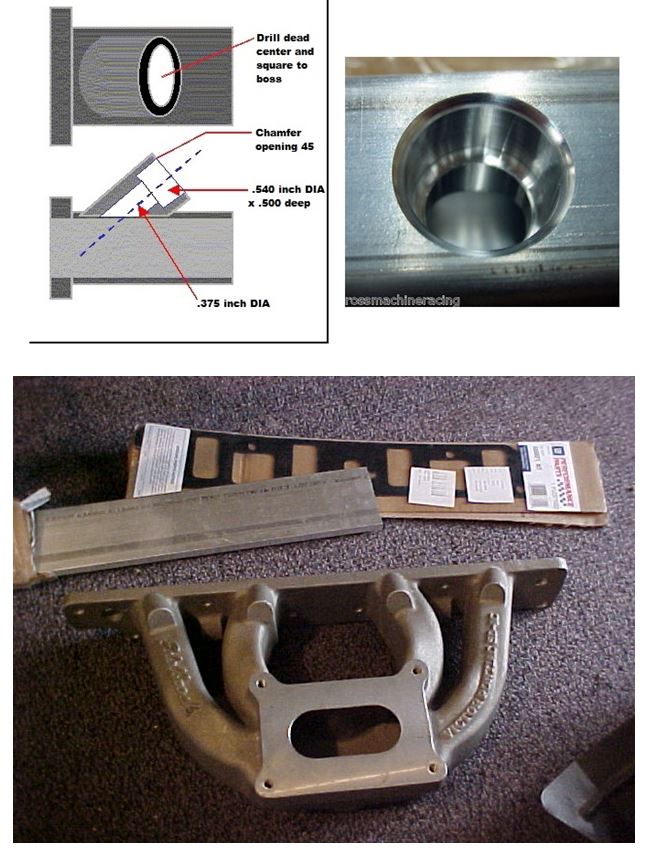

Working on a MPFI system using the Edelbrock 2-bbl intake.
The manifold was designed for mechanical fuel injection nozzles.
Luckily the bosses are beefy enough to be drilled for electronic injectors.
Edit: added this pic I found online

I did an Autocad drawing for the carb intake manifold-to-Throttle Body adapter and had it water-jetted.
The adapter bolts to the manifold. Then the Throttle Body bolts to the adapter.
The injector nozzles are dead center where they should be.
Manifold was drilled using a ShopSmith. We started with the center ones.
They were easy. The end ones have 2 angles to get right.
