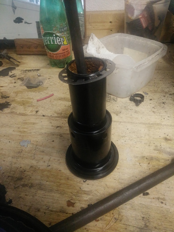

i am attempting to duplicate your frankenbooster. i went to the scrap yard and pulled a booster off a 95 GMC Sonoma 4cyl, 2wheel drive, rear drum brake model. i have found when attempting the conversion that there is a hole in the bottom due to a rust spot, that was not visible until i began cleaning it. Will this hole negate my vacuum?
Also i have had trouble pulling the snap ring off the Fiero plunger, but i took off the washer thingy off the back and removed the whole plastic cylinder with the plunger in it. i think that it just might fit into the Sonoma booster. How in the world did you get that snap ring off down deep in the hole of the cylinder?
Do you think that my idea will work? thanks jon
edit: since the booster is in vacuum (it is in vacuum no?) couldn't i repair the hole by cleaning well with a wire brush and sandpaper and solvent, and then use JB weld? The vacuum will be sucking in the repair, not pushing it out. ;-)
