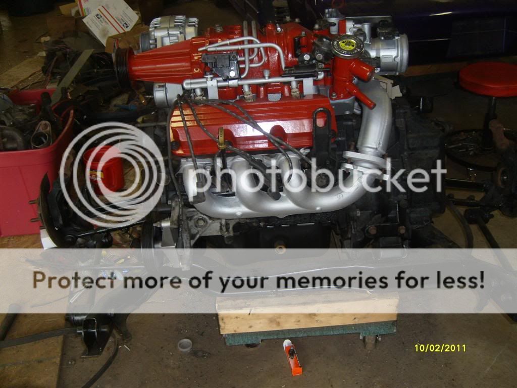

| quote | Originally posted by hercimer01: I tried but the hold downs for the fuel rail are in different locations when you swap it around. How would you anchor it down? |
I don't know about turning it around, but I cut that little center bracket so that I could use a pipe bender to point my lines towards the firewall of the car like this. Hope to get it in the car this weekend.

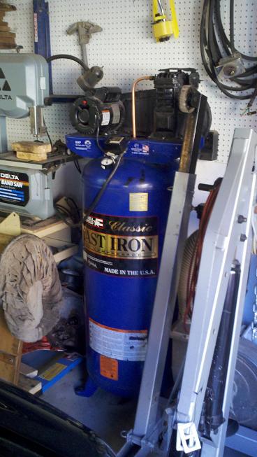

Thanks! I was hoping to be done by now. I ran into Murphys' Law lately. My air compressor crapped out. But I did come across a 60 gal. Ingersoll if I can get it for the right price. It is next to new. I'll need a good one for the paint.
hercimer01
OCT 09, 08:20 PM
Man I love craigslist, $200.00 cash. Now i'm back in business. Edit: Ingersoll Rand had really crappy reviews, Campbell Hausefeld had good reviews. Its a 6HP single stroke.

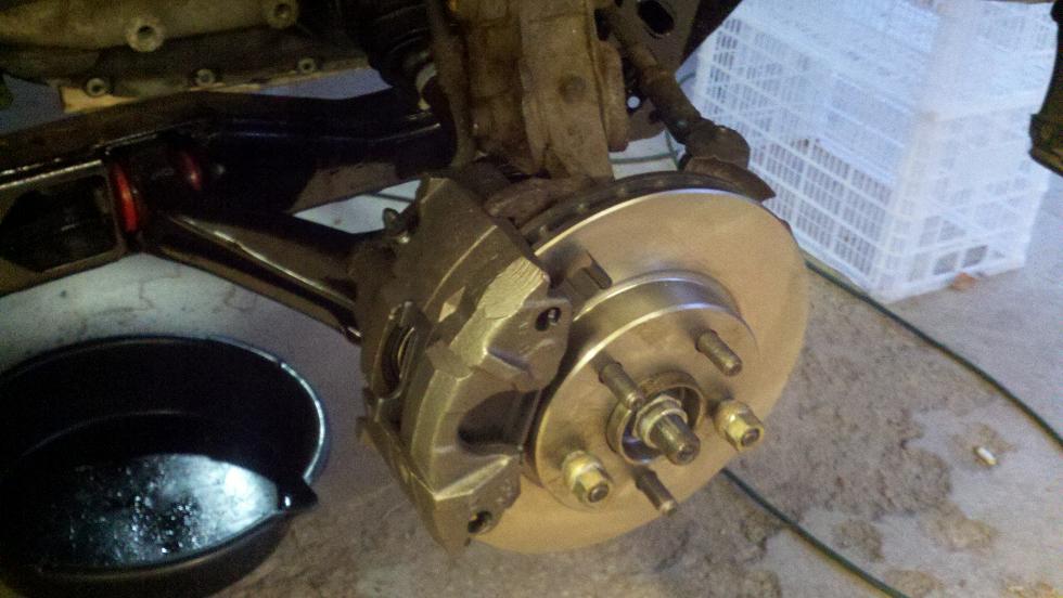

Grand Am brake upgrade, priceless.
I made this Dog Bone mount. Is that better DarkHorizon? I still have to grind and paint it. I will change the bushings too.
