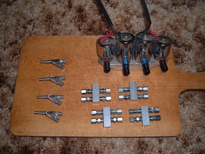

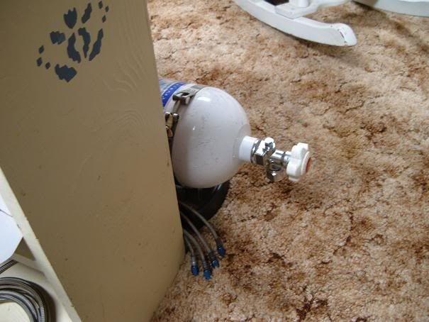

I got hungry so I cooked me up the rest of a direct port nitrous system. Mmmmm....Tasty.
Nawwwwzzzz baby, nawwwwwzzzzz...

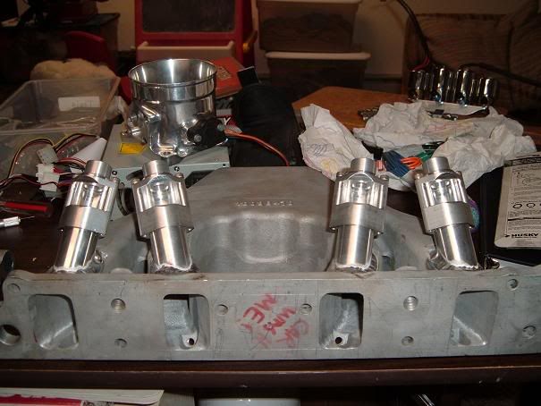

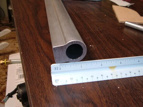

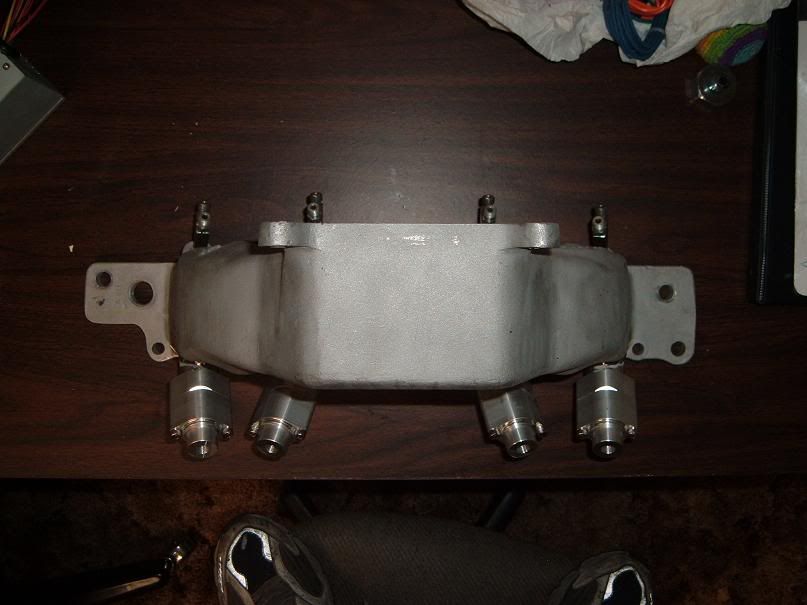

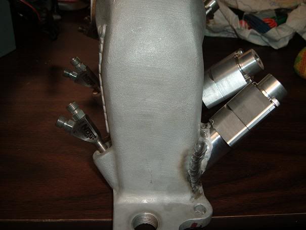

A true TSDB thread suprise.... Intake Manifold....DONE.
-10AN Fuel rail for good measure. I am planning on spraying up to a 150 shot.

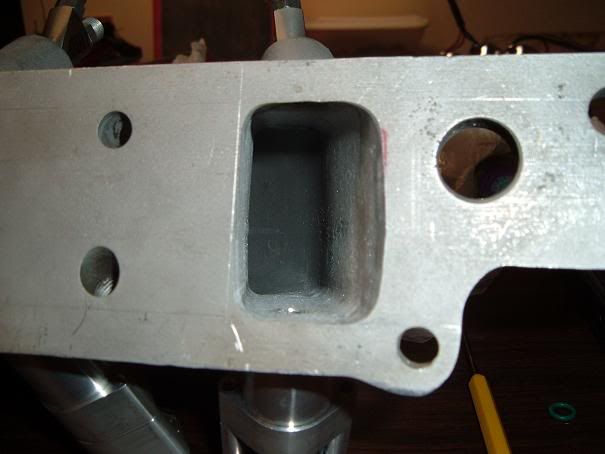

The best part is...
 The path of airflow. No intrusions.

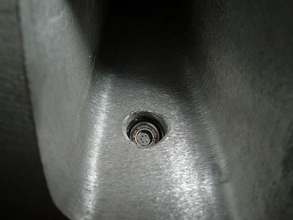

 Pic of the injector in its bore.
