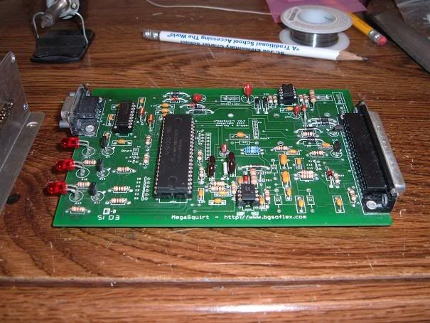

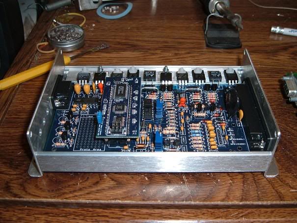

FastIndyFiero SEP 22, 12:55 PM
Out with the old:
blech!
In with the new:
Yay! This one even works.
