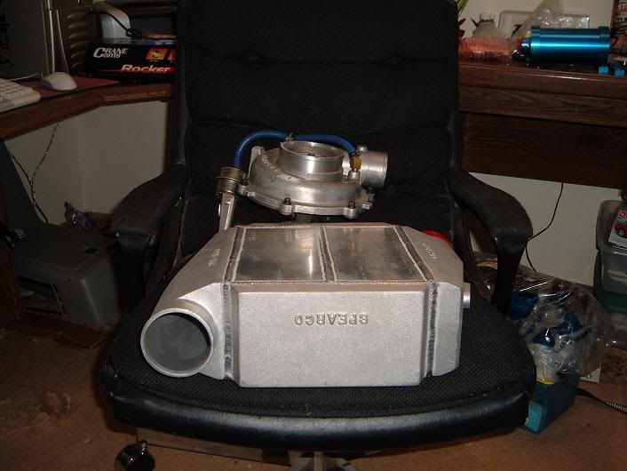

Spearco 2-230 water/air IC. FINALLY found it on eBay.

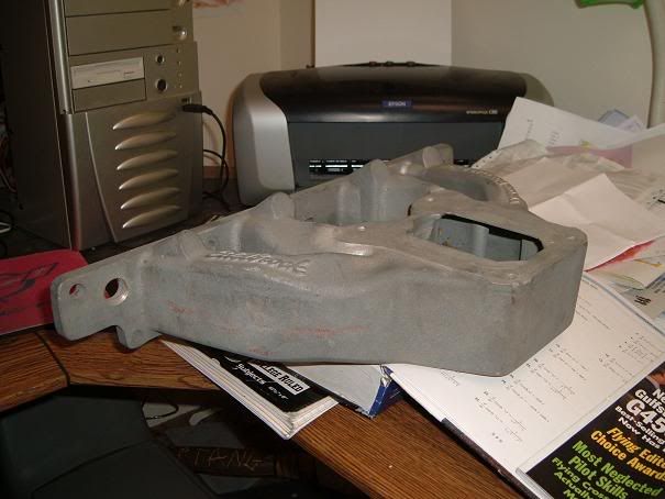

Yup. My 2bbl SD intake is for sale.

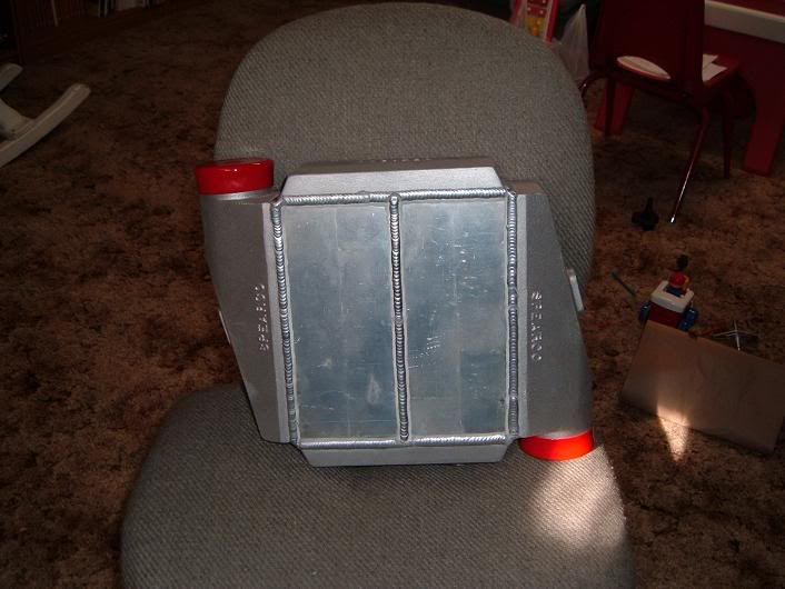

FastIndyFiero JUL 29, 06:50 PM
How to make mo powa...
big azz IC, yo
Spearco 2-230
im tellin u this sh-- is madd tite
Nate

Whats the cfm rating on that intercooler? Looks alittle more compact than a barrel type.
Nice progress so far!
FastIndyFiero JUL 29, 09:11 PM
Well, not really much progress so far, but thanks
The IC is rated to 1500CFM. It's actually kinda gigantic - those are 3" inlet/outlets. At 30psi, 700cfm, 400* intake temps, and 45* coolant, output is 81*, with a pressure drop of .18. I won't be running at 30 PSI (ok, I might not be running at 30 psi ), so the temp drop will be a little less, but my max CFM will probably be around 800-850, so it'll work out VERY well.

Thanks for the bump, man. Thought I'd mention that one of my SD intakes is on eBay.
http://cgi.ebay.com/ebaymotors/ws/eBayISAPI.dll?ViewItem&rd=1&item=7995353431&ssPageName=STRK:MESE:IT
