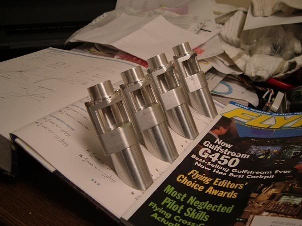

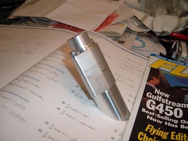

Time for an update:
Those are my new injector bosses. They'll solve some of my pesky fuel problems. Of course, right now the big thing is actually getting the engine into the car, having a tranny spacer plate made, and getting the mounts made. After that are all the little things. Nate

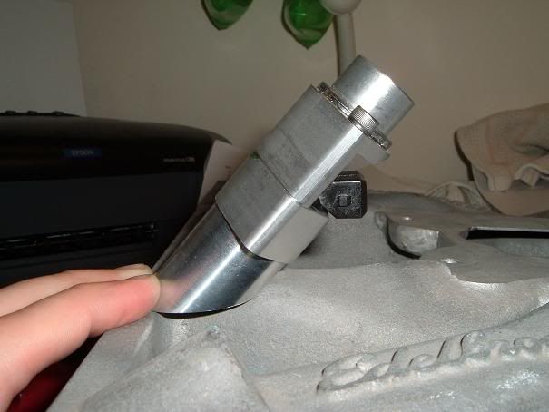

you going to weld those onto the edelbrock? or weld up a tube intake?

| quote | | Originally posted by Kohburn: you going to weld those onto the edelbrock? or weld up a tube intake? |
I'm going to spot face the existing bosses flat with the surface of the runner, then weld those on. I'd rather not deal with making another intake manifold. The last thing I have to deal with for the intake is getting these on and buying or welding up an elbow for the TB. Nate
