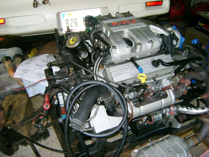

Installed upper intake manifold this morning and torqued it down. Added the power brake pipe before lowering the upper intake.Torqued crossover pipe, and added the heat shields.Installed new gaskets on the EGR pipe. Added MAP to the intake and tightened it down. Maybe back in the next week?
I need to move the dipstick either left or right just a bit. It is right in front of the power brake vacuum pipe.
As of this morning:

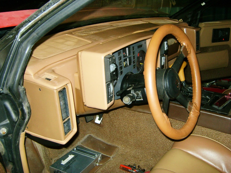

SEP 05, 03:01 PM
Went back out this morning to get a few things done. I installed the whole console parts and the auxiliary gauge pod. This was a time consuming item as I had forgotten which fasteners and such went into which holes. Trial and error.

SEP 05, 10:19 PM
| quote | Originally posted by katatak:
Moving along nicely Joe! The dash looks great. Waiting to hear it run! |
It actually looks better than the picture. The flash makes it look almost tan. The two end vent pieces were not recolored. I was trying to get it to look like a Formula Beechwood. I was able to get pretty darn close.
So close I can smell it! -Joe
