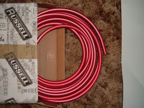

Another part:
 1/2" x 25ft Russell aluminum fuel line, for my feed and return lines from the tank.
