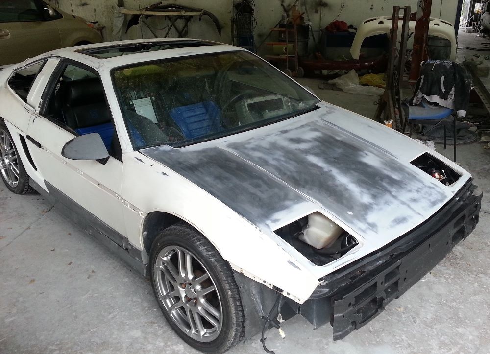

Here she is sitting in the paint shop:
You can see the front bumper in the background, a 355 bumper from JimmyS. Also the spoiler off in the background on the left. I did some prep work getting it ready for paint. I also went around the car with a grease pencil, and circled all the small nichs, chips and imperfections that I could find, and they are going to pay special attention to those spots. Also, the windshield is being pulled out prior to painting, as it is all delaminating in the corners. I have the glass company ready to install a new one at the paint shop before I drive it home.

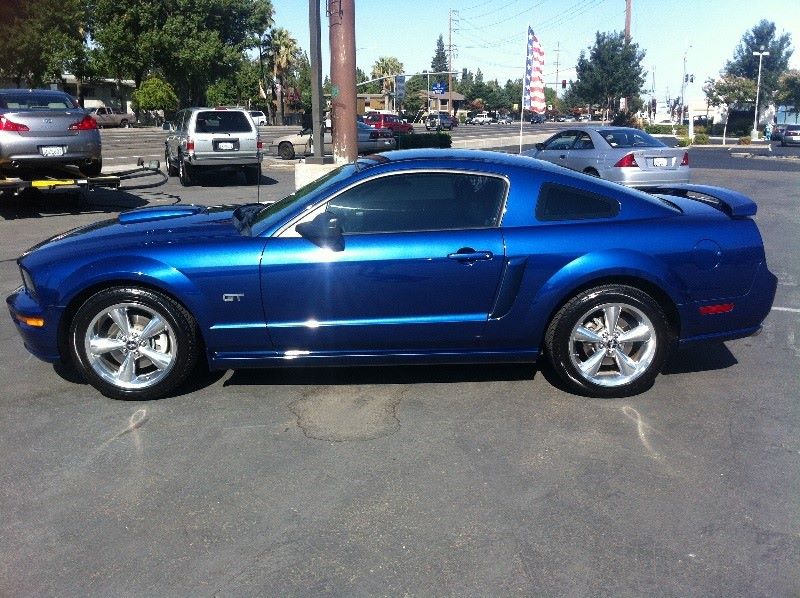

after looking for the past couple years at what seems like thousands of blue's, I finally settled on one. It is a metallic blue that was used on the 2007 Mustang:

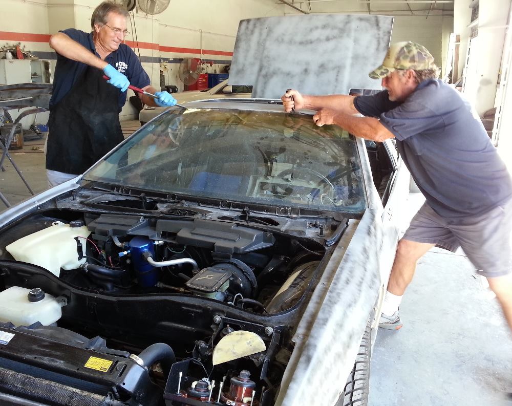

The glass guys showed up as well, to take out the windshield. They had one helluva time! It took them the better part of an hour. The rubber had completely dried out and it just did not want to cooperate.
