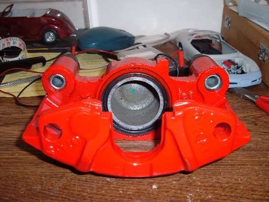

It's still been cold here, I guess it's still January after all (time to put the furnace back in the garage). I did a couple odds and ends to keep me busy when I wasn't getting started on school.
I worked on painting my calipers for a couple hours, still have one to do.

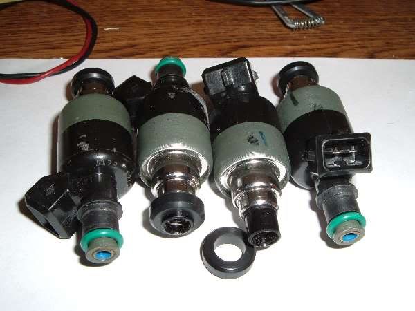

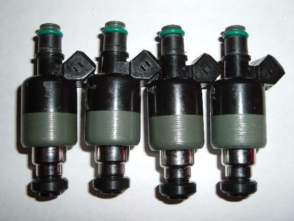

I have been wondering just what the hell these injectors that I got are. They are supposed to be domestic injectors, but what do import imjectors look like?
Kento JAN 28, 10:19 AM
Those look like the injectors I pulled off my 4.9 Caddy motor when I sold them.

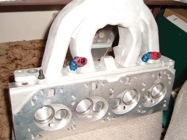

Fitting the manifold on the head. Need to trim up a couple areas on the manifold, but the die grinder froze up a while ago, and the dremel tool exploded. Darn, guess I need new tools.
