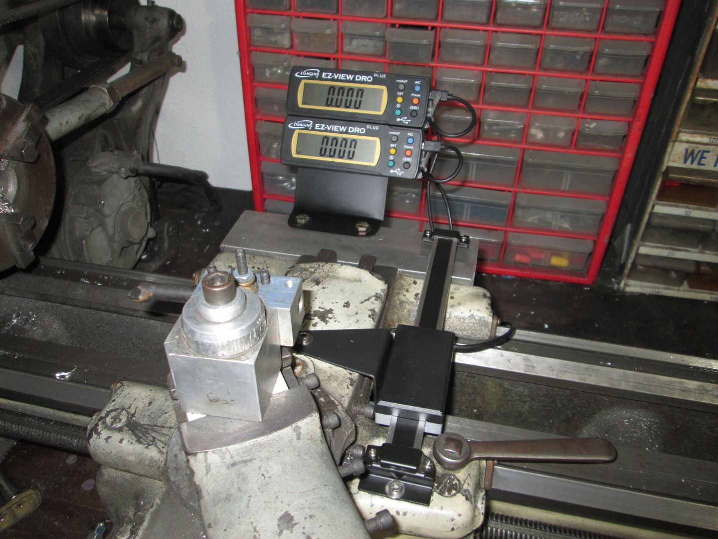

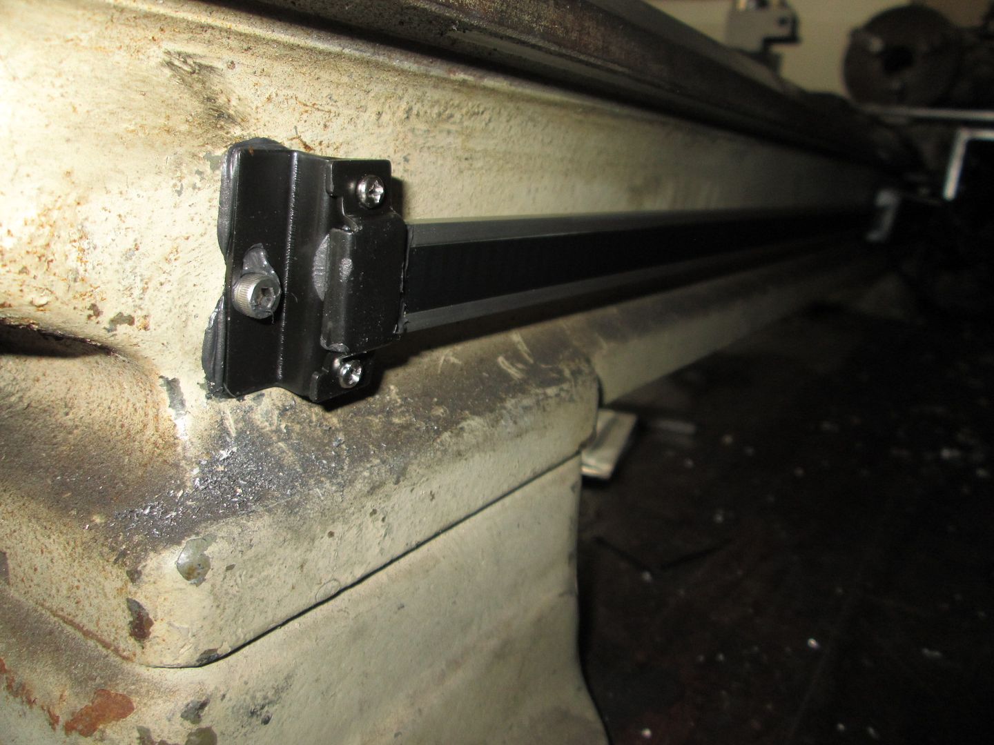

I picked up a DRO setup for the lathe and had a few hours today to get it installed. It was a universal setup, so I ended up making some of the brackets so they better fit this application.

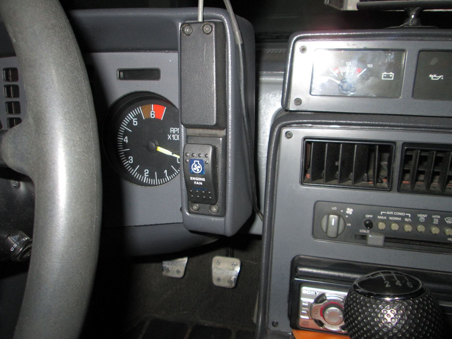

I am also going to swap out the thermostat for a 180 one and install a fan override switch. The cooling system is rock solid and quickly cools the engine when the car is moving or when the fan is on. I want to disable ecm control of the fan, but I would like to manually turn the fan on in the staging lanes to keep the car as cool as possible before the run.

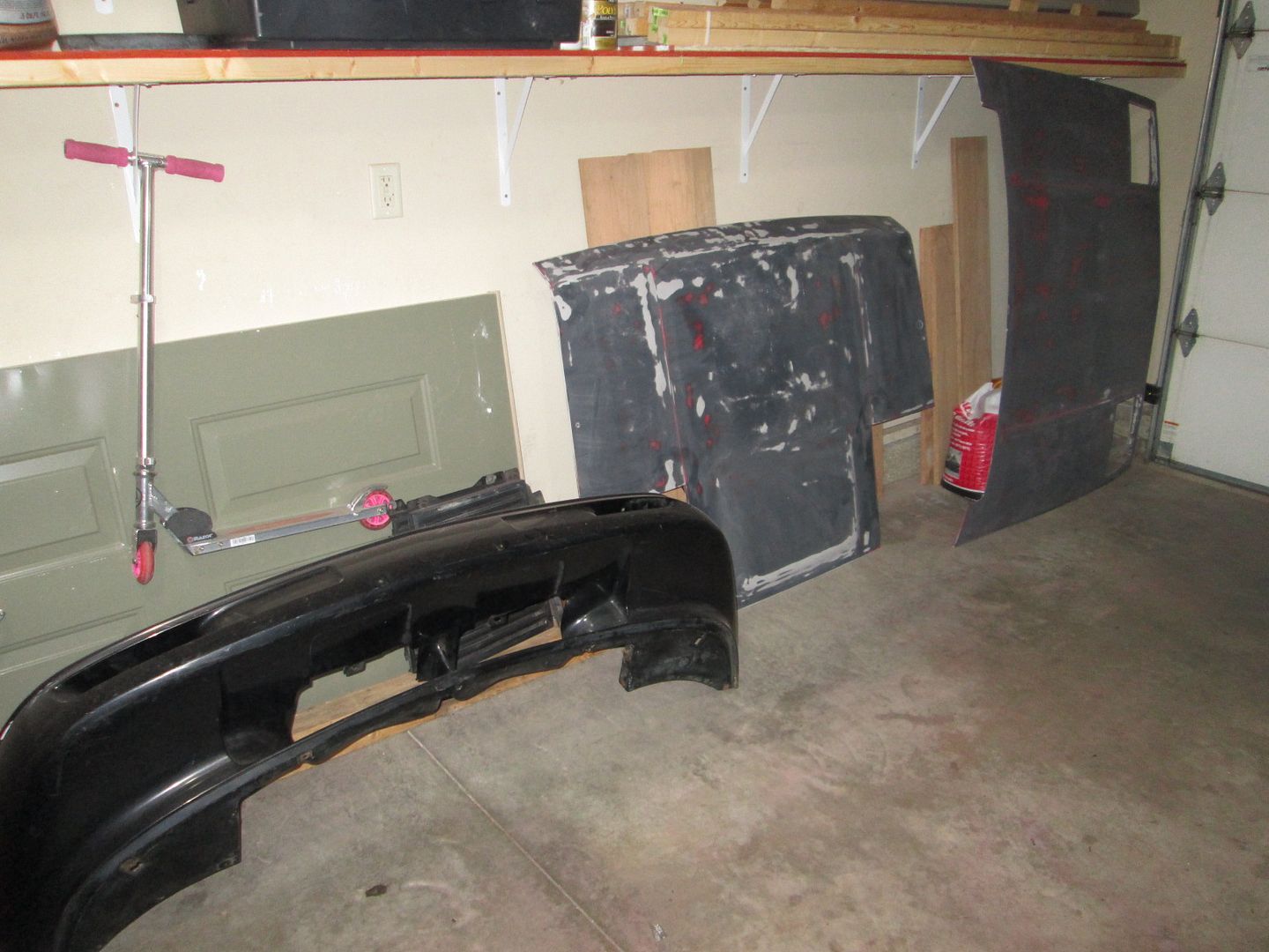

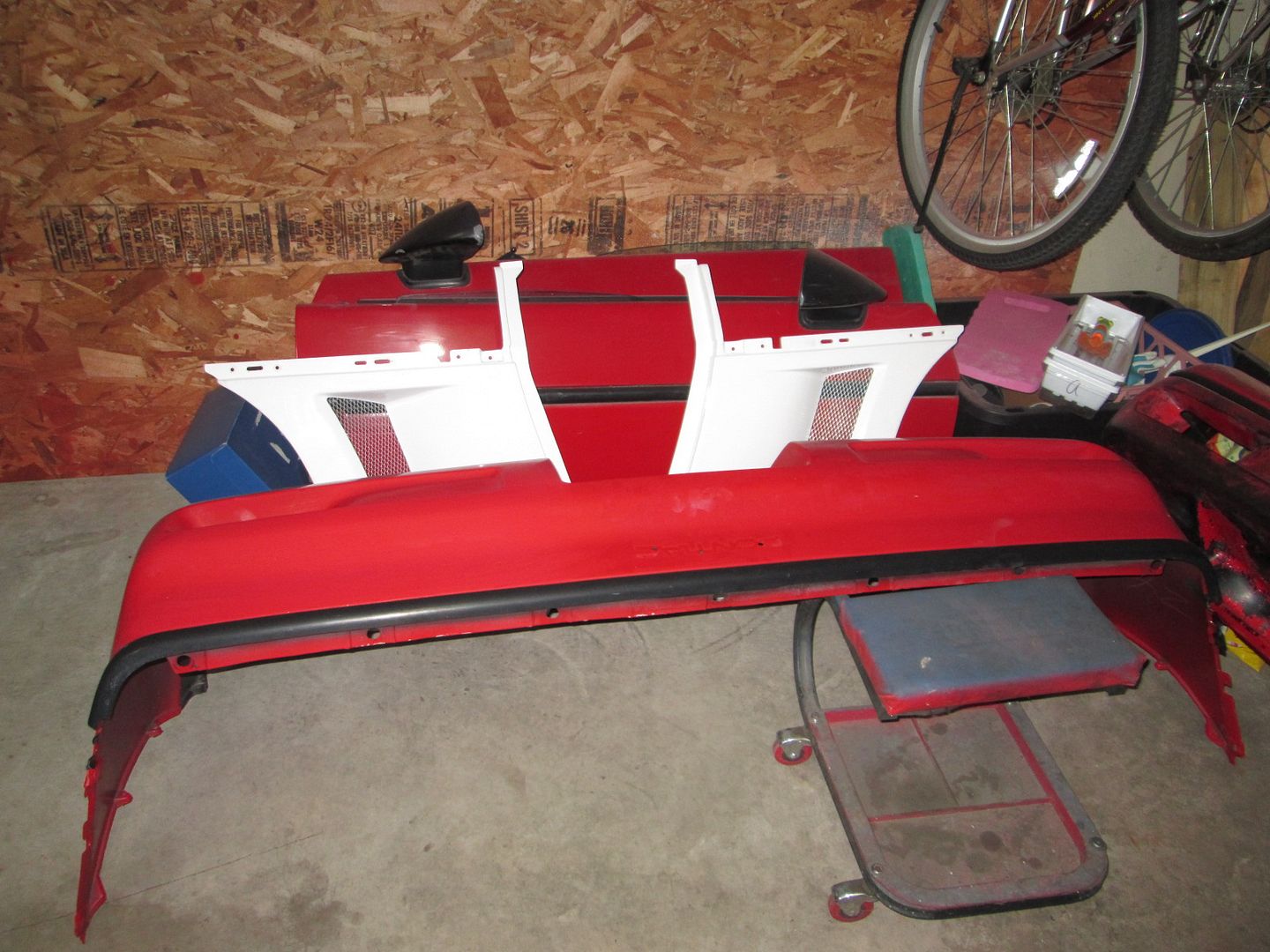

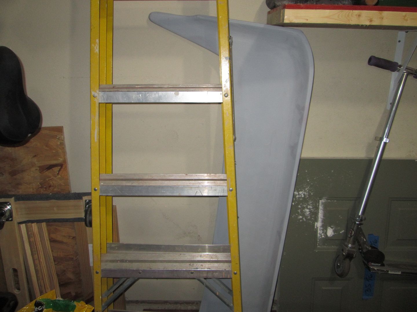

My big project for the summer is to address the paint on the car. It is pretty much a disaster from certain angles, so I want to paint it. I really don't want to take the car down for months while I slowly make progress on the paint, or pay someone to paint it. So I have a complete set of spare panels that I am slowly working on. With this work, I am also adding trans am vents to the fenders, IMSA 1/4 panels, mustang convertible whale tail spoiler, and I am currently exploring options for a hood vent. I also plan to eliminate the antenna hole, all badge holes in the front and rear fascias, as well as Pontiac in the DS front headlight...

Over the past few weekends, I installed the 180 thermostat, the fan manual override switch, configured the scanner upgrade on HP Tuners to datalog with the wideband for MAF as well as Virtural VE tables, and did a lot of WOT as well as normal part throttle data logging. Overall the tune was pretty close, but I did make a few small changes.
I really wanted a fan override switch that was about 10 to 25% smaller than this one, but couldn't find one I liked. https://www.amazon.com/SUND...arling/dp/B00P3TIS70

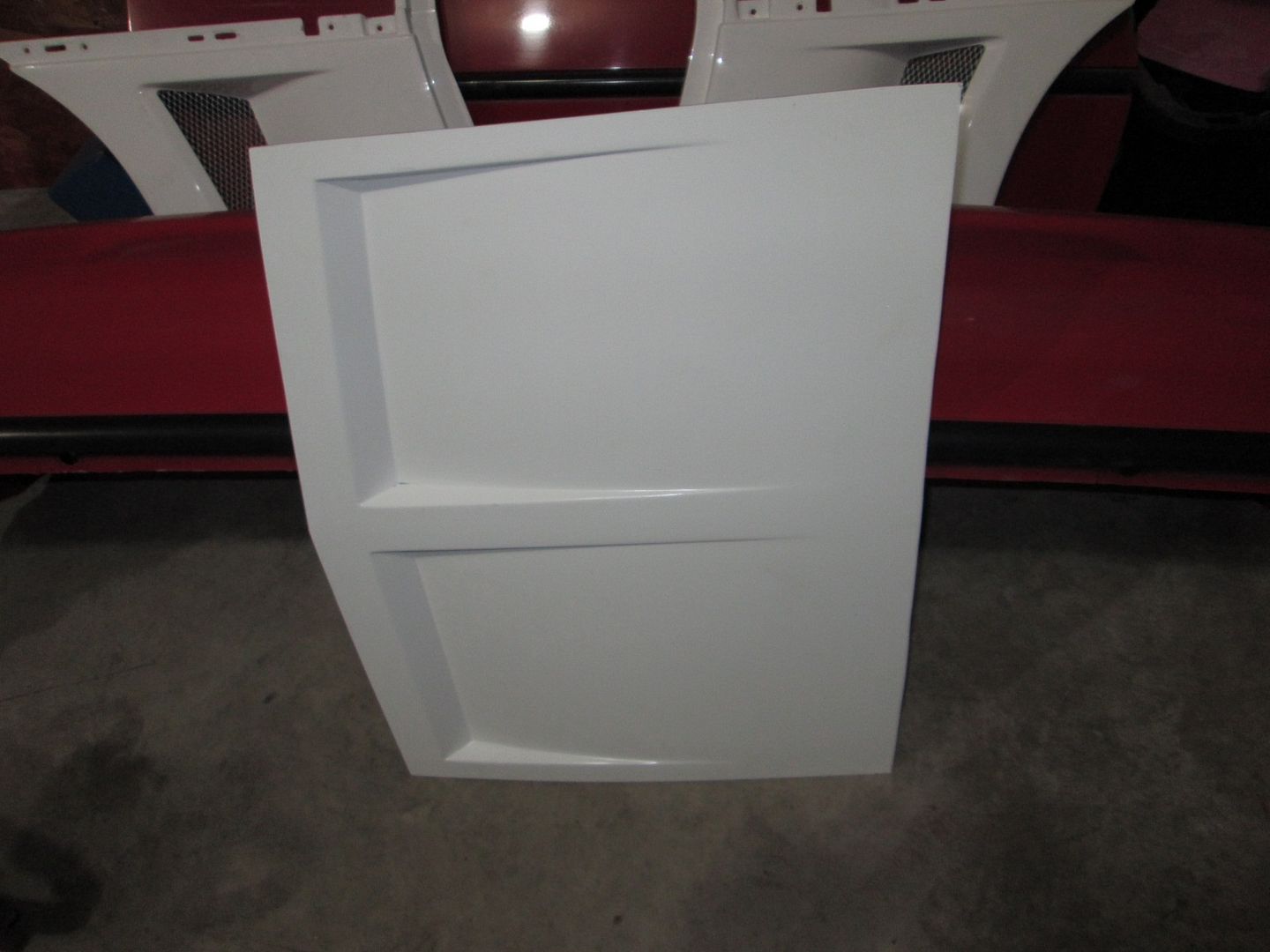

I haven't had any time to get back to sanding panels, but I did picke up a STM hood vent from The Driver
