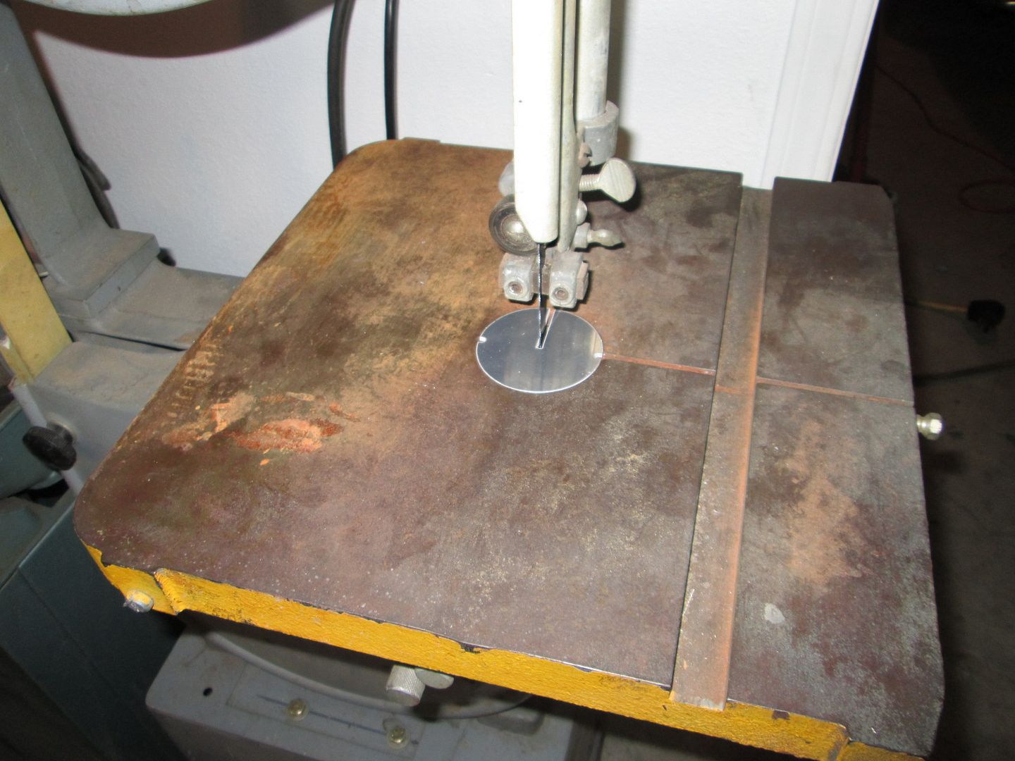

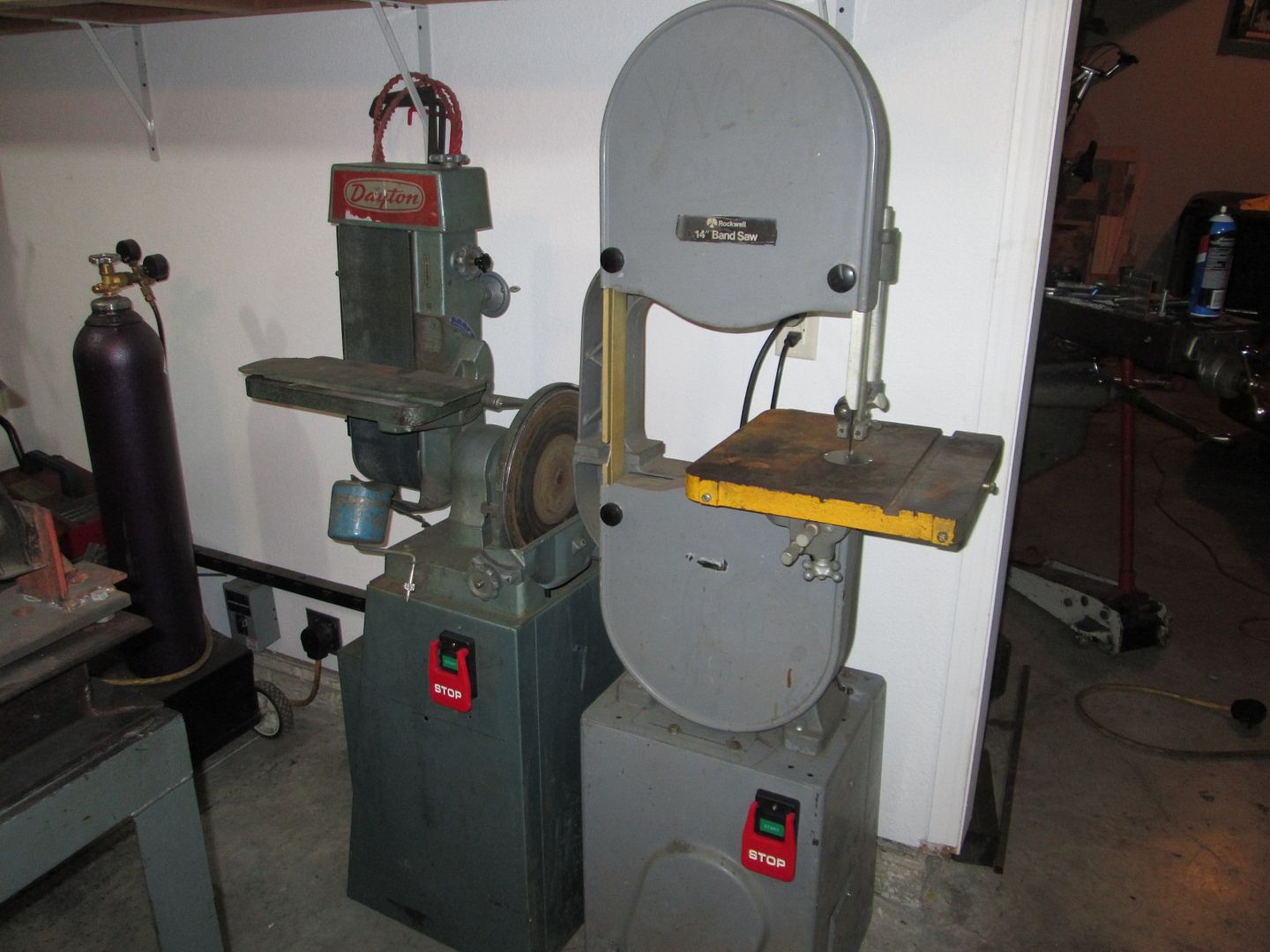

The cap for the bandsaw table came in earlier this week and I finally got the on/off switch installed for the band saw and belt sander. Now I just need to buy a new 48x6 belt for the sander and I can start putting them both to work.

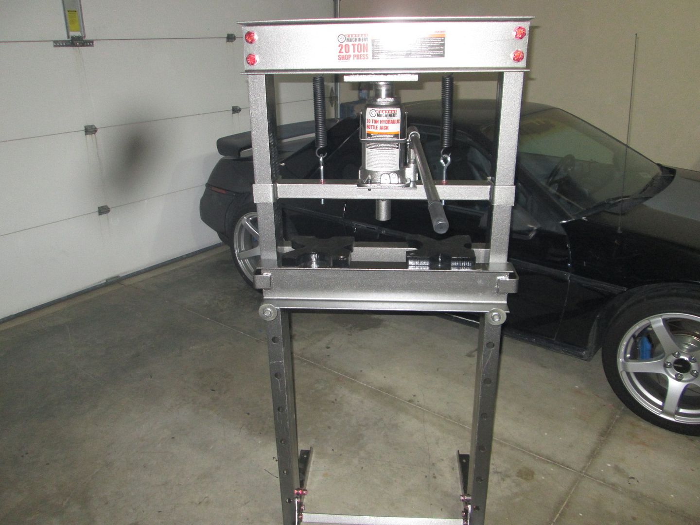

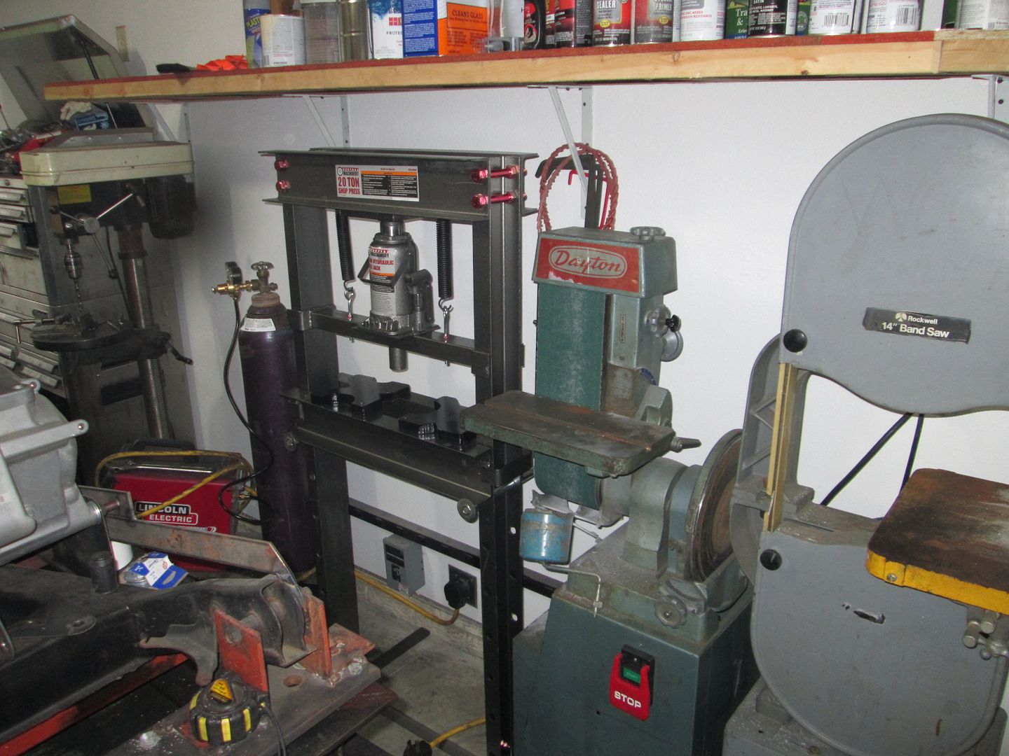

That got me thinking about other handy tools that I should add to my garage. On Black Friday I added a 20 ton harbor freight press to the garage. I am not a fan of harbor freight bolts, so all the hardware was swapped out with higher rated and more reliable parts.
I made some room for the press next to the belt sander (did I mention I need a larger garage):

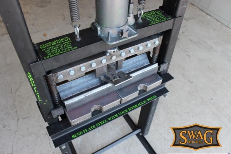

Now the reason I wanted/needed the 20 ton press was to get this:
The finger press hasn't arrived yet, but this is what it will look like once I get it and assemble it. With it I will be able to bend much thicker metal with minimal effort!

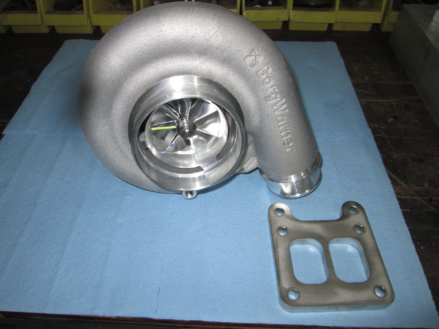

So this showed up today!
This was inside...
Borg Warner S369sx-e supercore. It is the latest generation turbo from BW and supports 950+ hp without the excessive size of the 400 series turbos, which will make it easier (but probably not "easy" to fit in my engine bay). For phase one, I am "only" looking for 600 whp on E85, but wanted good reliable turbo with room to grow.
Here are the specs S300SX-E SuperCore Assembly 9180 69.00mm / 2.72'' Compressor Inducer Dia. 91.44mm / 3.60'' Compressor Wheel O.D. 73.37mm / 2.89'' Turbine Exducer Dia. 79.75mm / 3.14'' Turbine Wheel O.D. Straight Compressor Outlet
Here is the compressor map:
The exhaust housing is a T4 80 mm twin volute with 1.0 AR designed specifically for the S300sx-e supercore series, but it hasn't arrived yet...
