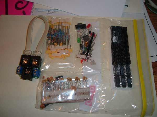

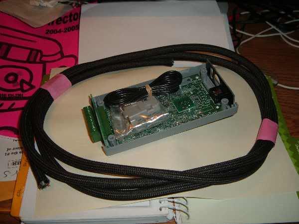

Here's a couple pics of the next toy:
TechEdge wideband 2A0 unit. I still need to purchase the LSU sensor. It doesn't look very hard to assemble, hopefully I can get that done sometime next week.
Nate

Well, between studying for finals and working on the car, I've somehow managed to keep myself busy this week. I'm just finishing up the wideband sensor cable. The controller end of the cable turned out to be quite a ____ . After I get done with the cables, which shouldn't take long, I can get started on the main unit.
More later
Nate
