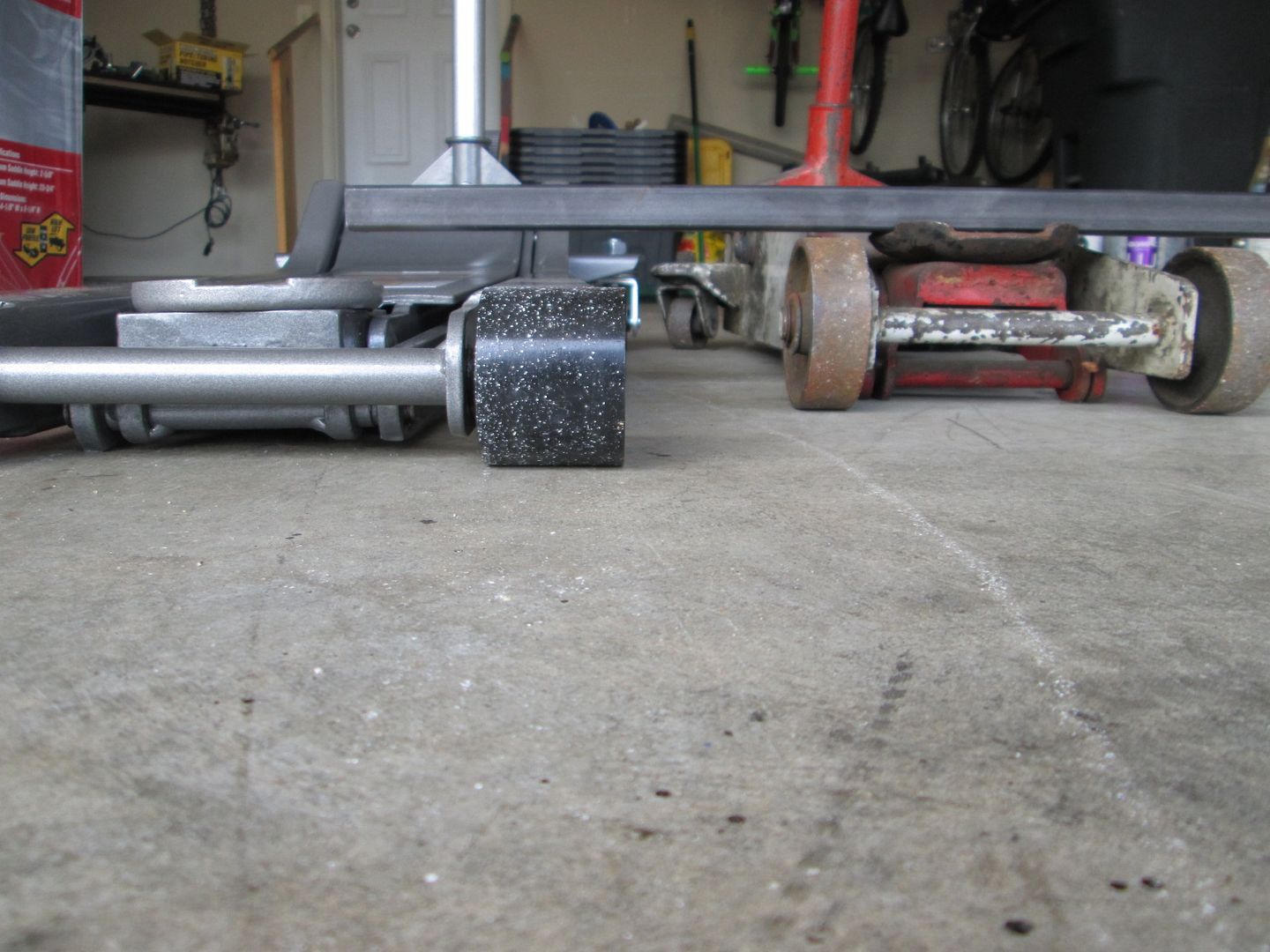

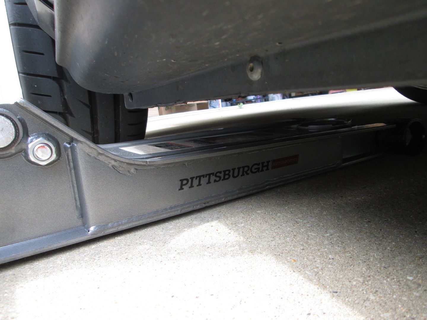

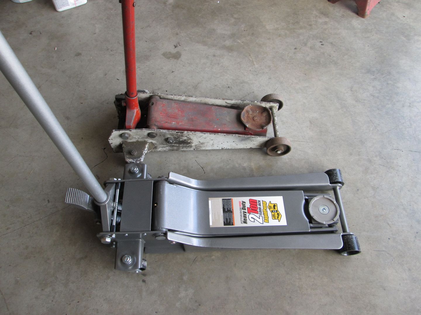

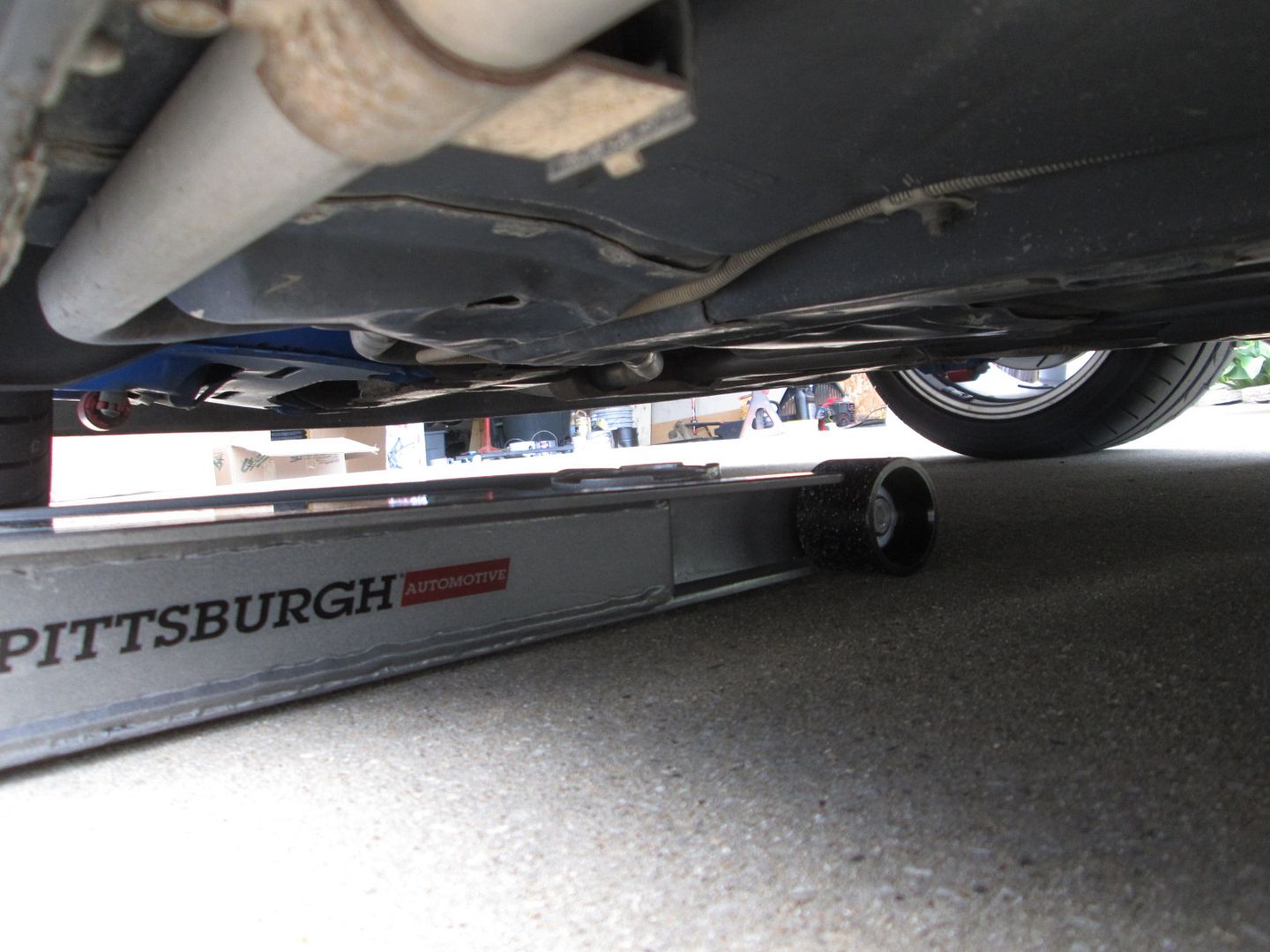

A new tool joined the collection in the garage today. After something like 20 years with my old Larin jack, I finally picked up a new one from Harbor Freight (the Larin jack will still be in the tool rotation).
My primary goal was lower profile and a longer reach so it would be easier to jack up the LS4/F40 Fiero that has been lowered. To use the Larin jack, I would push it in as far as it would go, jack it lightly to slide the tire in, then lower it some (it would now sit higher due to the tire movement), and slide it in far enough to lift on the lower frame rails.
Time will tell how durable this jack is, but I really like the low profile (about 1 1/4" lower than the Larin) and nose length!
Here is what I was after! The jack pad is right under the front lower frame rail:

How low is that jack? i.e. how much clearance do you need? I'm having real issues with my jack as I build my Aventador...it's just so damn low that I almost can't get the front end jacked up. Right now I can squeeze the jack through the vents in the front bumper...but once the grills are installed that option will go away. Your jack may be the answer...
