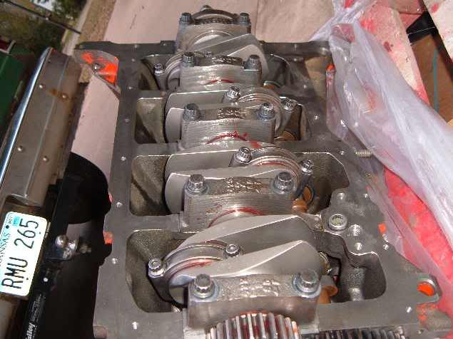

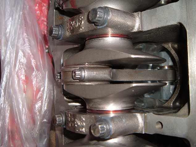

Recipe for one bullet proof bottom end: One (1) Super Duty block:
 Four (4) forged, heat-treated, shot-peened, 4340 steel, KRP rods with 7/16" ARP bolts:
 Four (4) forged aluminum, lightweight Diamond Racing pistons:
 One (1) billet steel SCAT crankshaft:
 Mix at 9000RPM, add boost. Repeat.

You may have mentioned this earlier -- but what kind of compression are you planning on having with those pistons? It looks great! --Bryson
FastIndyFiero
NOV 26, 07:51 PM
| quote | | Originally posted by bryson: You may have mentioned this earlier -- but what kind of compression are you planning on having with those pistons? It looks great! --Bryson |
Thanks! When will you start on Quad #2? I'm sure I will be following that as closely as the original. I'll be sitting at right around 8.35:1 CR. Couldn't have come out better. Another bonus is that the pistons top out at .070" under the deck surface, so I won't have to have them recessed for valve clearance. I will have to figure out a way to mount the oil pump pickup, as the bottom end was previously set up for a dry sump system, so it doesn't have a stud on the main cap where the oil pump pickup bolts on.
All in all, though, I'm very happy with the way it looks. Clearances all checked out (well they better!), not too tight and not too loose, no runout on the gears. I'll be coating the block soon with Aluminum POR engine enamel. Should improve the looks alot. After all, what good is HP if it doesn't look pretty?
