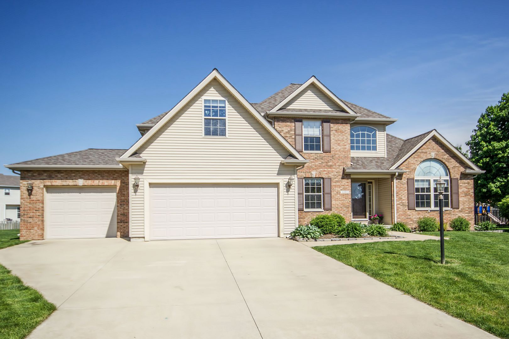

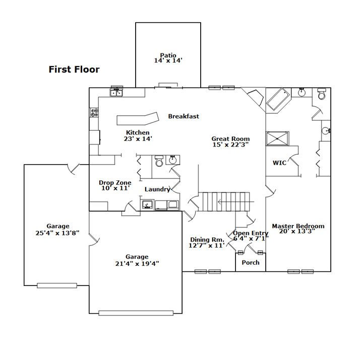

In other news, we had an offer accepted on a house and should close on Nov, 10th, about 1 year and 2 weeks after I transferred back to IL. It's a 5 br, 2.5 bath (3rd full bath roughed in in the basement), 3200 sq-ft, main floor master suite, partially finished basement, 3 car garage, 0.37 acres, at the end of a cul-de-sac. Its has everything Sara wanted in a house, but the lot is a little smaller than I wanted, but it will save on grass mowing time.
The subdivision covenants specify a minimum of 2 car garage, but no maximum. Only restrictions are the garage has to be attached, match the house construction, and the total house foot print can't exceed 33% of the lot sq-ft. The covenants also do not restrict running a home based business, so long term we think this house will work well.
I am hoping everything works out and I can add a 23x40 shop area behind the 3rd garage and against the kitchen wall next spring.

I love the Drop zone. I need that in my next house.
GL with the move.

Thanks guys! Its more house that we need, but the location, covenants, and price ($6K less than it was built for in 2005) were perfect, and most importantly it makes the wife happy. Our house in KY was 1975 sq ft, so we were looking for something in the 2500 sq-ft range with 4br to have a spare for guests and a basement for tornados/TV/movie center. But with the girls upstairs bedrooms being a little smaller than we had in KY, having the 3rd upstairs bedroom as a common toy/lounge area for them will work out well.
The drop zone is going to be cut in half and walk-in pantry added to the wall next to the kitchen including its own door from the kitchen. That, finishing the basement bathroom, staining the kitchen cabinets darker, and painting all the wood trim white are the only immediate plans for the house. I have been working on an AutoCAD layout of the garage with all my equipment, but will likely use the 3rd garage for tool/work area, and leave the cars in the 2 car bay... until I expand the garage area... hopefully next summer.

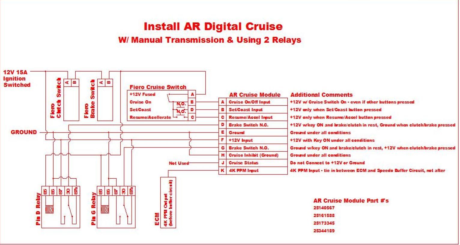

So after a month or so of messing with cruise control, I can claim victory as it now works!!!! It took 3 AR modules to find one that actually worked, but now it does!
First I have to thank Klingon Fiero, Darth Fiero, and all the others who posted detailed information about this setup on PFF!
I wired mine up a little different than most others, wiring the brake and clutch (actually a 2nd Fiero brake switch mounted to the clutch pedal) switches in series (so either will cancel the cruise) and used 2 relays for the D & G inputs that must switch between +12V and Ground. When 1 relay is used, the ground signal when the relay is off had to go through the unpowered relay coil and had about 100 ohms resistance which wasn't as strong of a signal as I wanted. It wasn't working at the time (probably for some other reason), so I added the 2nd relay to eliminate it as the cause, but then it still wouldn't work until I got another AR module. Also, as part of the debug process, I found that my cruise stalk was bad, so I replaced it with a new one.
Here is my wiring schematic, I also added the troubleshooting info as well, so its all in one document. Use it at your own risk...
With the harness built this way, it literally was a 3 wire hook-up (power, ground, VSS) and plugging in the connectors at the brake, clutch, and cruise stalk.[This message has been edited by fieroguru (edited 09-19-2015).]
