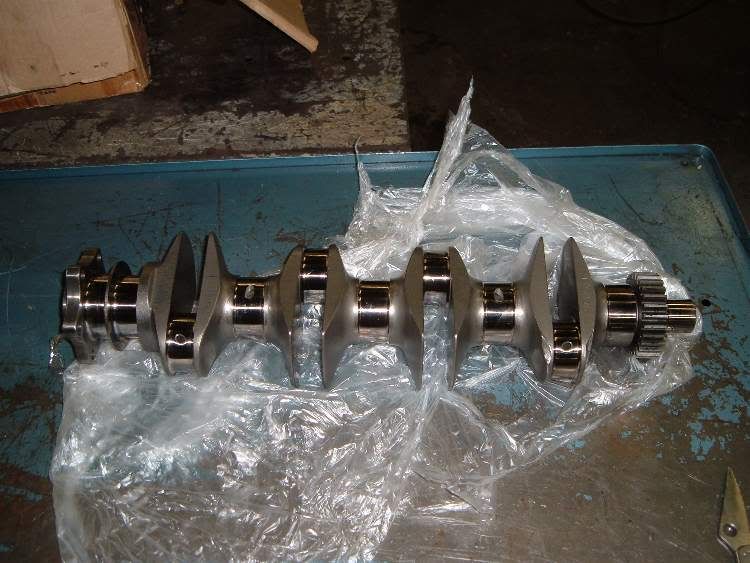

I finally managed to snap a couple final pics before assembly: Crankshaft, after journal polish:

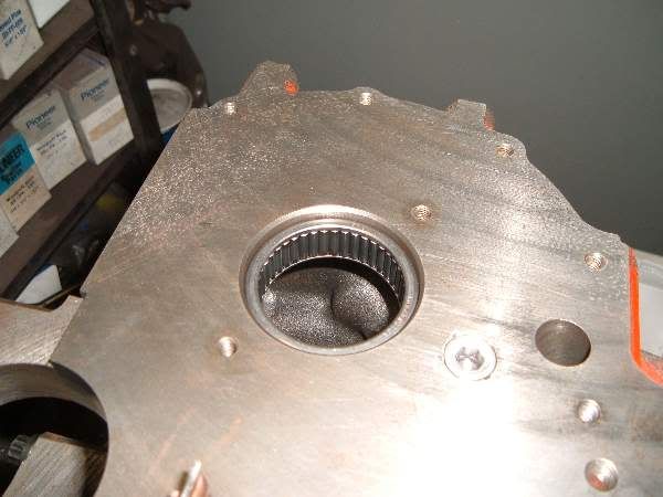

 Torrington roller cam bearing:

That crank is beautiful....

Page 354, I think? The other people in my class didn't understand my excitement on that page.  Here's still my biggest problem with this swap:
 The SBC bolt pattern on the end. My plan so far is to retain the pattern on the crank, and machine a bellhousing spacer to sit in between the engine and the trans. Then of course a custom aluminum flywheel. Now I play the waiting game again, though.
