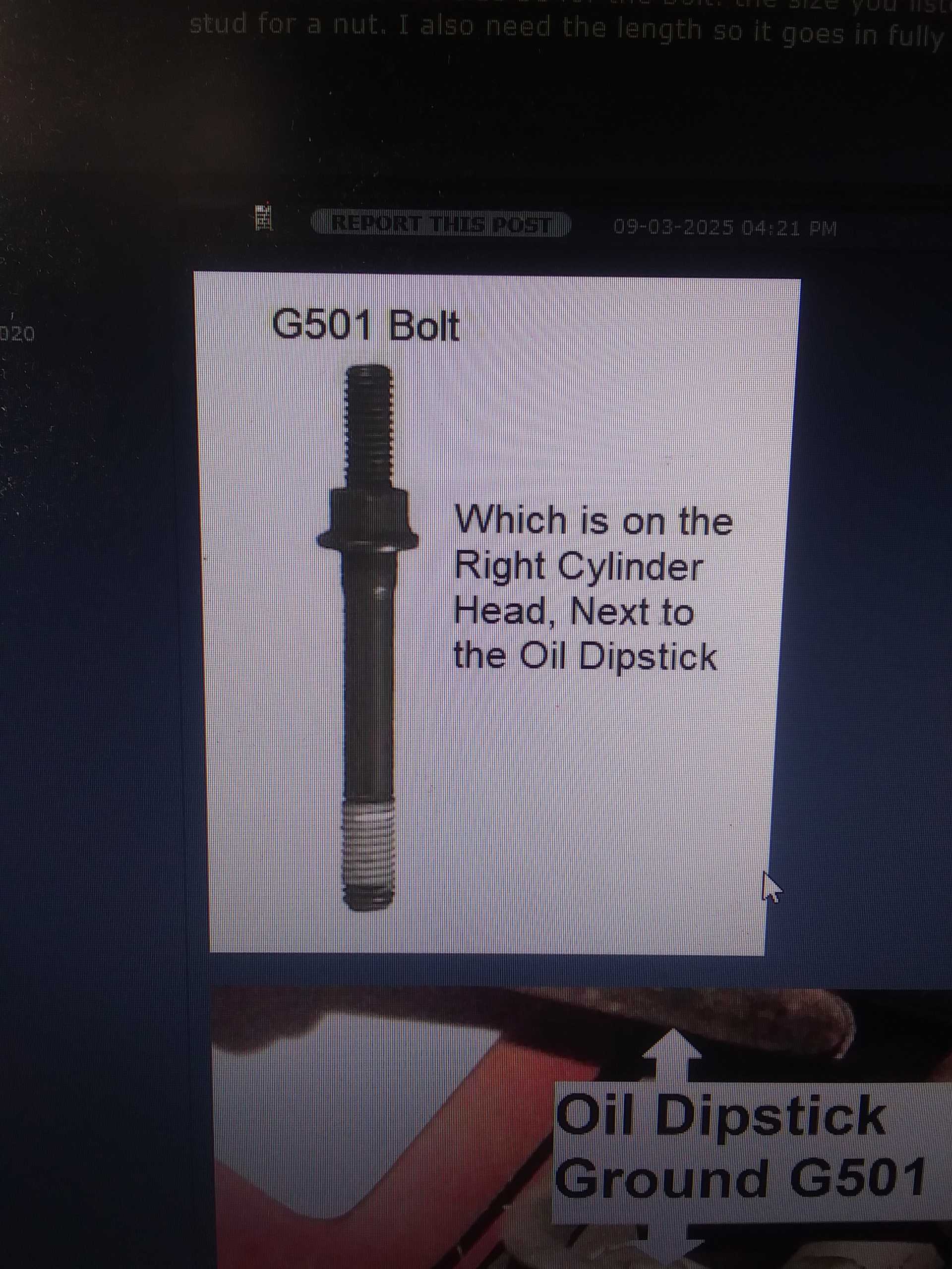

I've been on the look for one for so long but can't find it. Mine is missing. It's a location on the engine where a ground can connect. The location is called G501. If you can either find this bolt or happen to have a parts engine you can take it off of I'll buy it.

I did bolt the ground in a different spot but I still want the complete engine. I want to buy that bolt.
I also tried NAPA. they weren't much help.
The bolt isn't in the engine block set either.
its a rare bolt

no its not a rare bolt. its easy to get if you buy actual headbolts for the 2.8l v6, theres the actual fel pro part number and it even has that bolt, and why would it be in the block gasket set? its always in the headbolt sets which are sold separately
ES 72857
i hate being that guy but like cmon man. you have 3 threads on this and actually got answers in the first 2 and someone who was gonna sell you one and you havent actually showed anyone your engine so far so none of us can see any other issues you may have which might be more than you think
