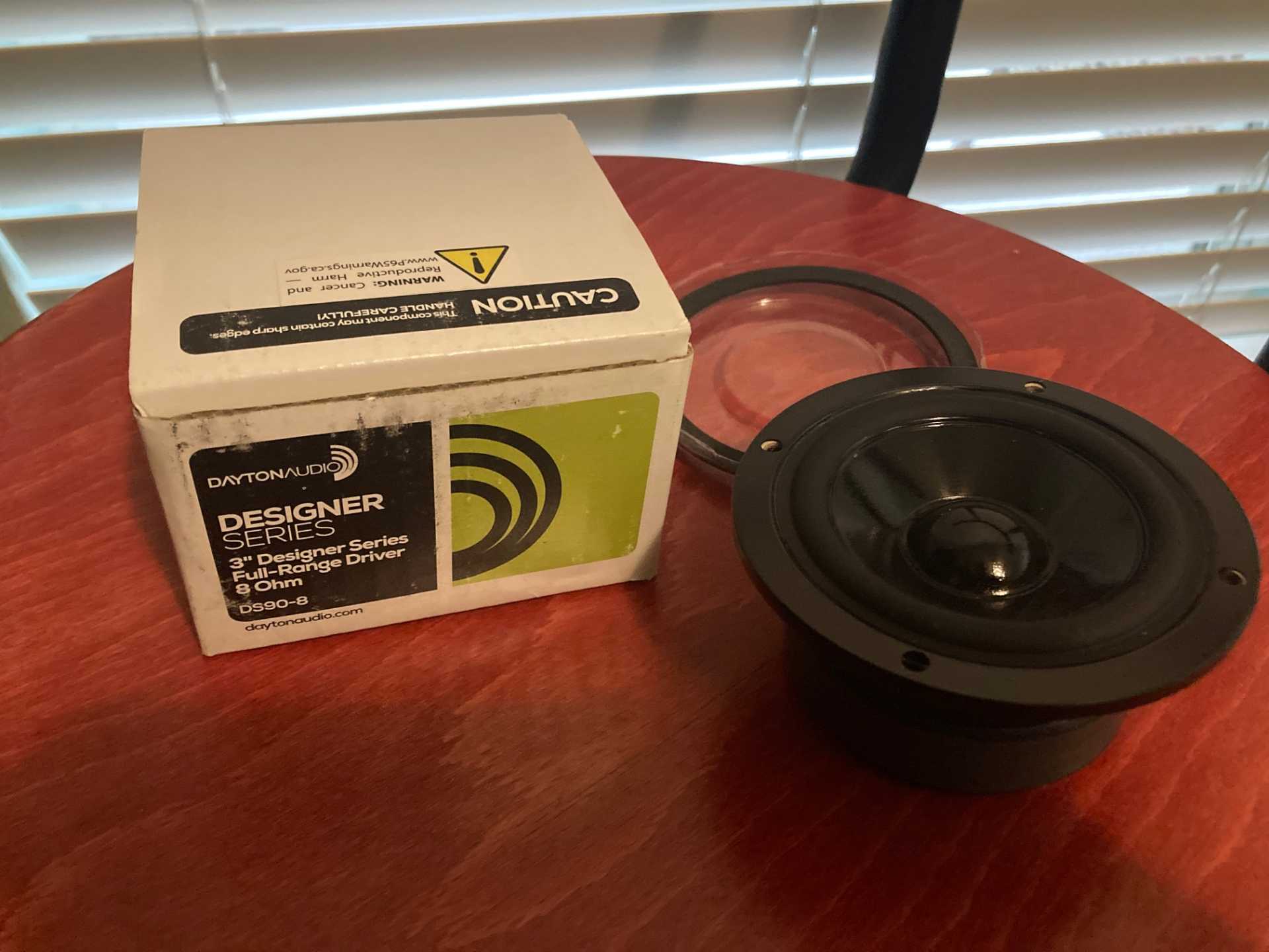

Hi! The speakers are a SLIM 3.5", and there are several decent replacement speakers for them. I just bought a set (3") and have tested them (at least one set) in one of the seats, and it sounded really good:
I don't know that you'd want to put tweeters in there. It would likely be pretty piercing right behind your head. There's a couple of threads, which I'll post below... and in at least one of them, someone (or two) complained about that...

EDIT: Also... I'm no electrical engineer, I got a CompSCI, but the factory speakers are 10 Ohms of resistance, and when paired together (left and left rear speakers, and right and right rear speakers), it makes 5 Ohms of resistance. If you were to use 4 Ohm speakers, you'd end up with 2 Ohms of resistance, which just won't work. So those speakers (above) that I bought are 8 Ohm each, and when combined, give you 4 Ohms of resistance, which is really what you want (and also what my daughter's front speakers are as well).[This message has been edited by 82-T/A [At Work] (edited 12-11-2024).]
