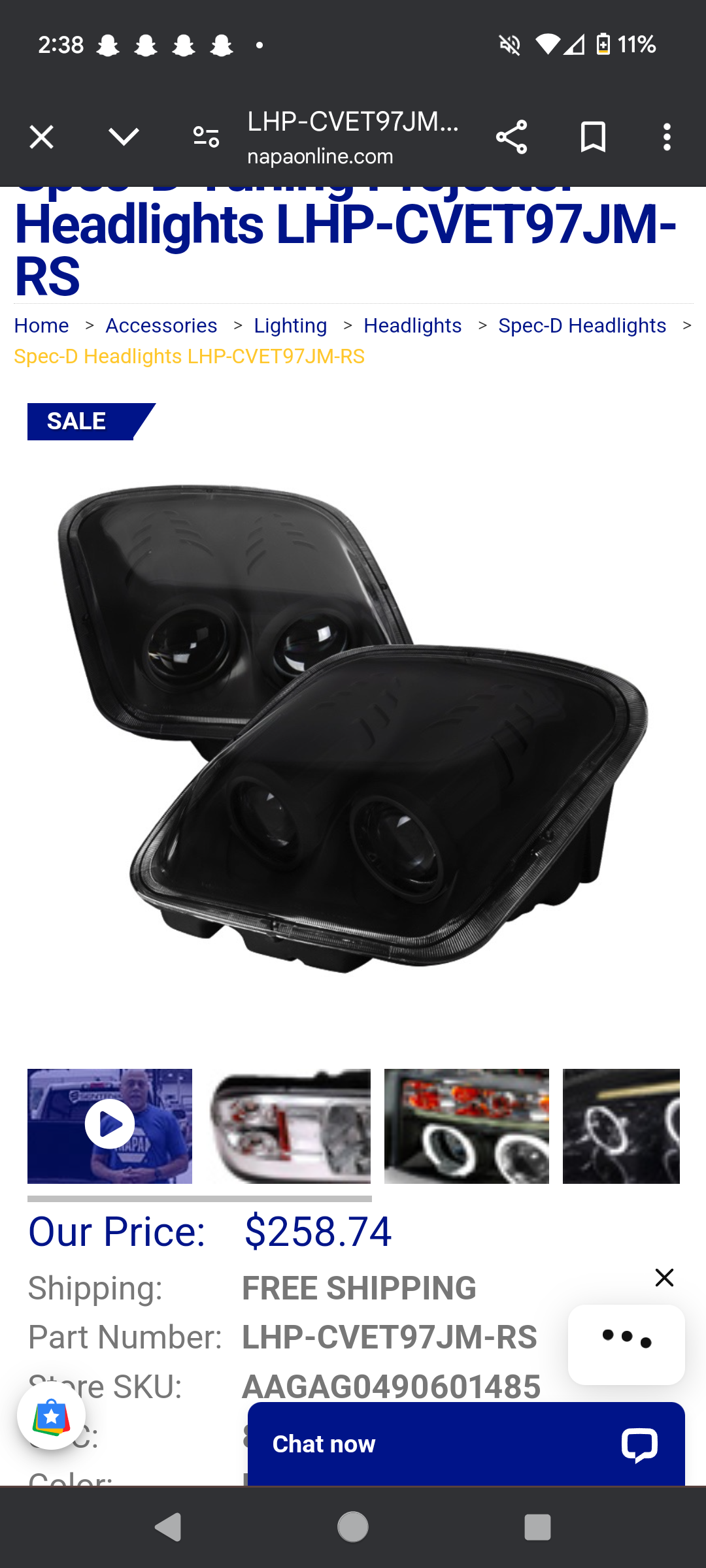

I was thinking of switching out the pop up lights for some smooth fit lights but couldn't find any of the style I like on the internet but found these at Napa(linked below) and was wondering if they'd fit without cutting any panels, hood, or fenders. Because I don't know the measurement of stock C4 headlights and can't find anything online. I'm not
worried about mounting I can come up with my own thing.
https://www.napaonline.com/...-headlights/1d3dfd09

It is doubtful that these flush headlights would fit the Fiero, A while ago there were two different headlight conversions for the Fiero. One was the Munson system while the other looked similar to the one in the picture that you posted. Last month a member was selling the Munson style headlights but I'll need to search to provide you the info.

You are not going to find a flush mount kit for another car that will fit a fiero w/o lots, and lots of work. Here are several of them that have been done in the past:

Thanks everyone for the responses I really appreciate it! I won't be getting flush lights after the mention of it being illegal I really don't want to risk being ticketed. But I was just going to upgrade the stock lights so I can see at night and thought new buckets and such would be a good aesthetic mod. But looks like I'm going to stick to the popups and replace the bulbs. Again thanks!

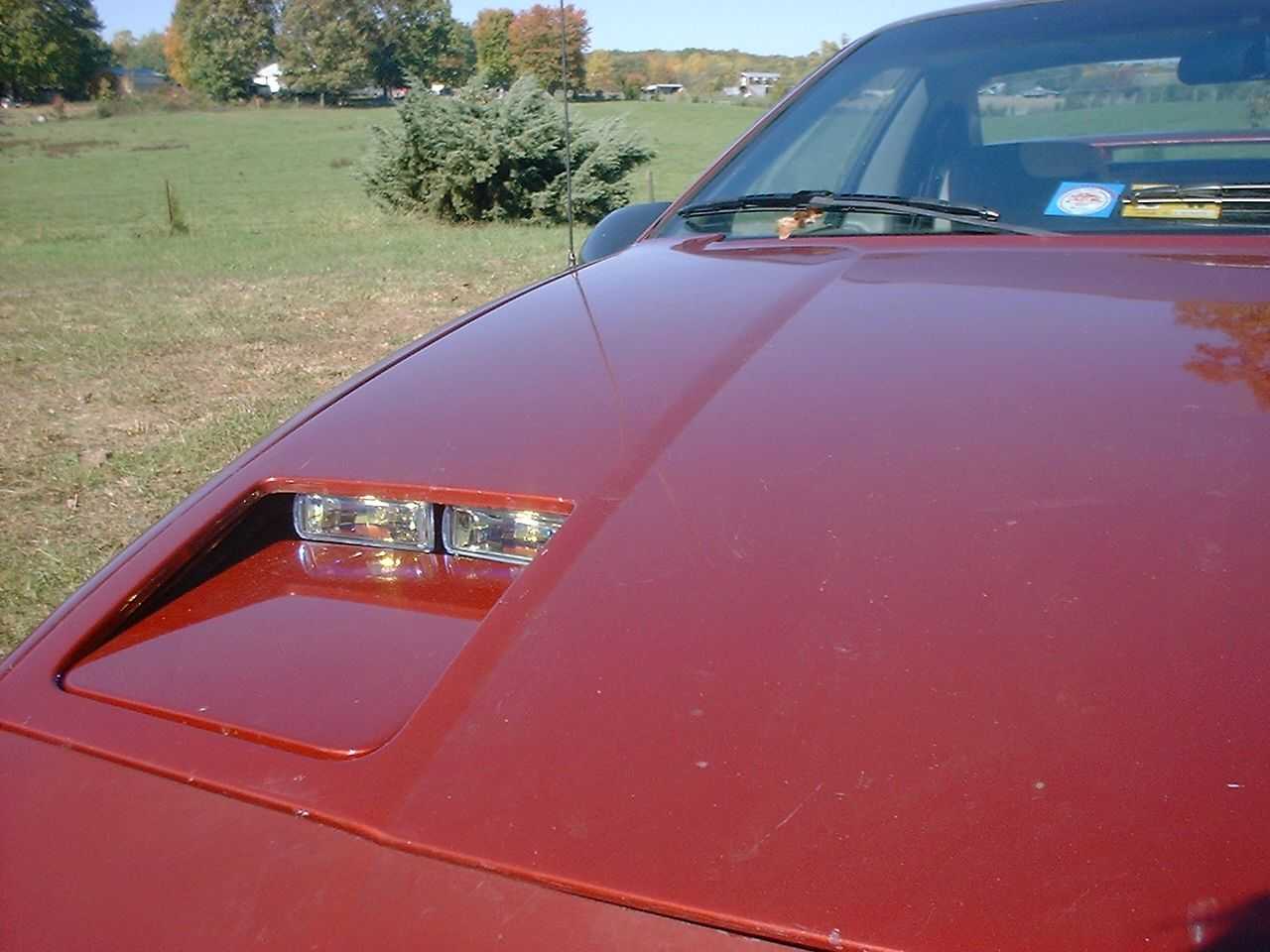

I have this low profile headlight mod on my 88 Mera and like the way the lower headlights look. I used Hella 4 x 6 H4 halogen headlamps, great beam pattern, much better light than the stock sealed beams. They are ECE beam pattern.
