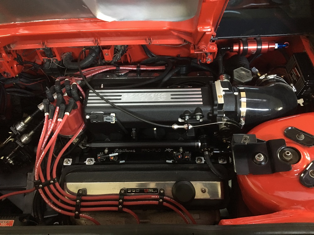

I have a non LT1 SBC in mine, changing plugs is easy from under the car, the front bank is harder, especially the one behind the alternator, due to access, but is doable. Mine runs about 180 degrees, with an electric water pump and a Champion Aluminum radiator, I also have a thermostatically controlled engine oil cooler. Not sure how complex the LT1 intake is, but it should all be acessable from the top, I have swapped manifolds on mine before, just keep track of all the parts/fasteners. And take pictures before you disassemble!

That engine bay is stunning.. Very nice.
