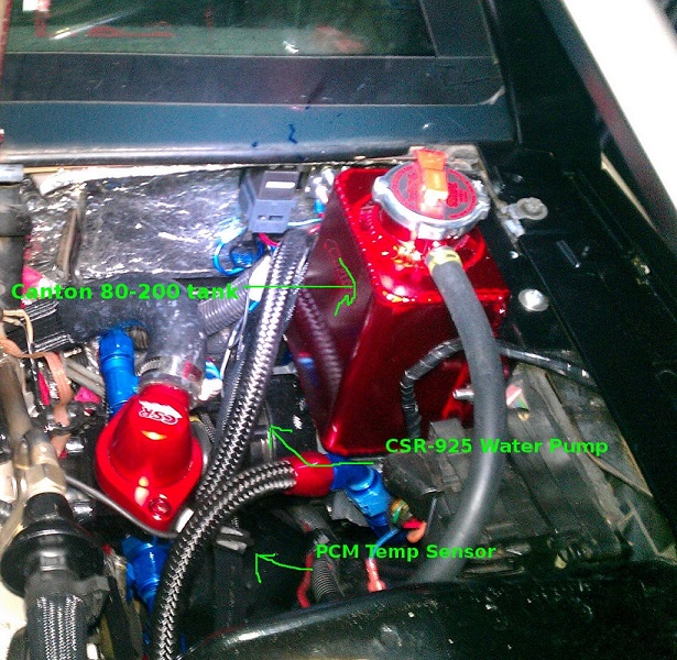

cyrus88
AUG 18, 07:48 PM
Yes it's a remote WP.
I junked the stock pump and made adapters to accept 1/2-NPT. I also used a remote thermostat neck.
As you can see from my first picture, the pump is on the pass side behind the firewall and in front of the wheel well.

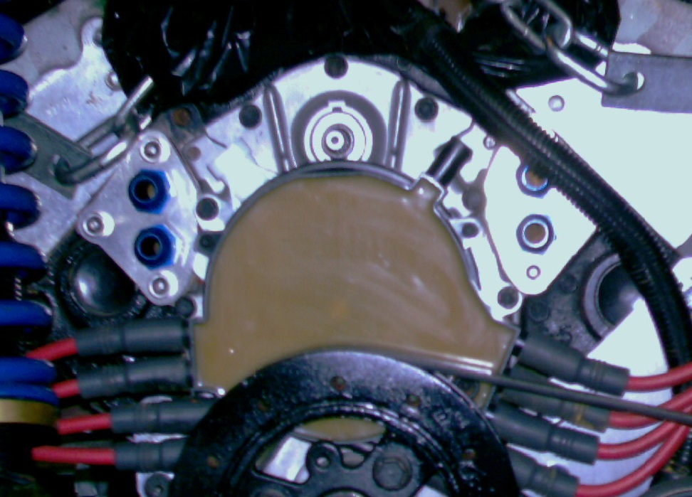

cyrus88
AUG 18, 08:00 PM
This pic shows the adapters and lack of stock WP.
If you can't make your own, shop for remote water pump adapters for LT-1 on the net. I remember seeing some, but can't remember where.

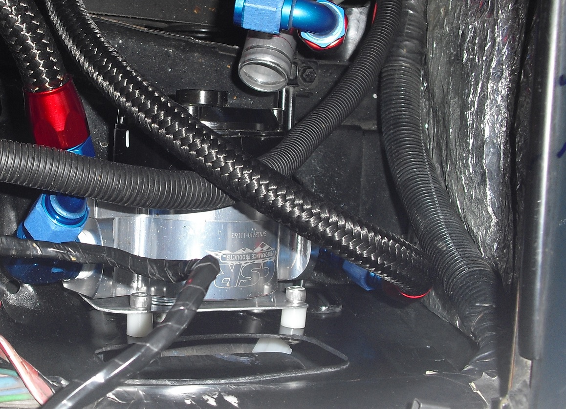

cyrus88
AUG 19, 03:46 PM
Not a very good pic, but I have posted this one before somewhere on this forum:
The remote thermostat is Moroso 63426. I drilled and tapped the side for the PCM temp sensor (the one that is normally on the LT-1 water pump)
The goose neck is a CSR swivel kind.
