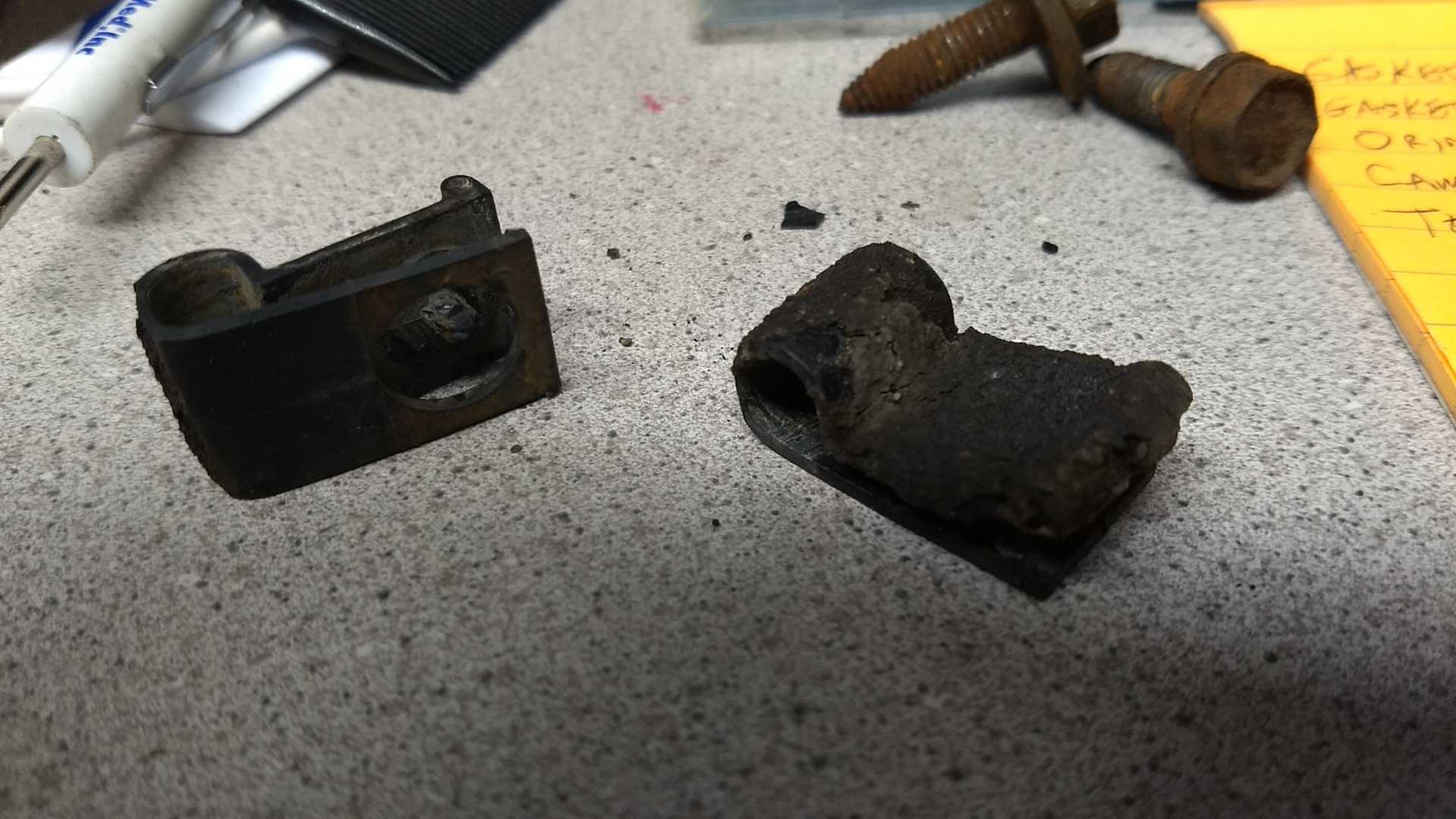

I know it is a little item, but here is the pic..
 They are under the spare tire bucket, they strap the brake line to the metal brackets. I know that I can just wire tie it together, but that is not quite right.. given a choice, I would get new plastic clips.. I do not see them on Rodney or TFS.. Based on this post.. http://www.fiero.nl/forum/Forum2/HTML/132585.html I may be asking too much. Anyone seen this before?

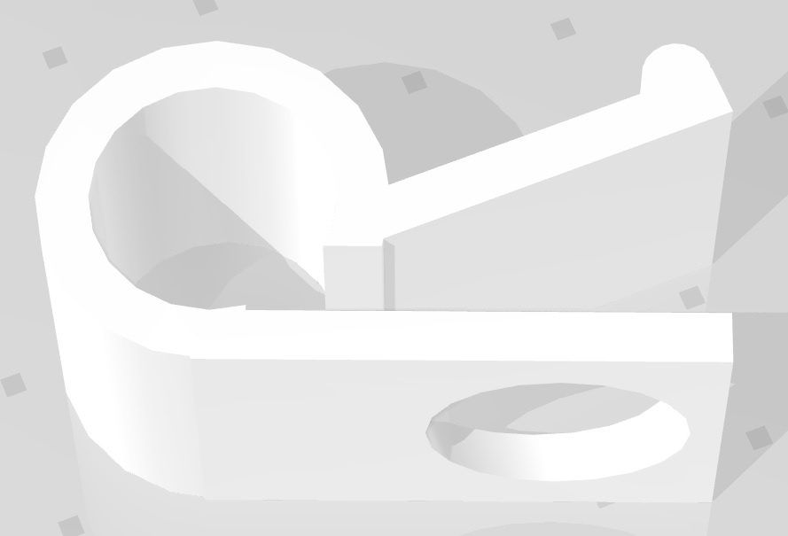

Something like this?
Send me measurements for the clip (I'm too old to go climbing under my car to do it!) and I'll see if I can 3D print one?------------------ Anything I might say is probably worth what you paid for it, so treat it accordingly!

these clips are still available from gm part# 11609821 and 19130464. From the latest gm parts catalog.
dan[This message has been edited by bonaduce (edited 07-14-2020).]
JUL 14, 06:12 PM
Many GM dealers including online don't list them. go to same site and look in Fiero brakes, BRAKE PEDAL & MASTER CYLINDER MOUNTING number 43 in the img doesn't list below at all.
Those "clips" don't do much. Barely holds if something/someone hits/hooks the brake line.
Many types of plastic or plastic on metal "cable clamps" like dremu above and more will work. And likely do a better job. Could use small nut&bolt, zip ties, etc. to attach to wall part.
Even nylon zip ties will work just don't pull the ties tight and force the line to bend to meet metal bracket.
Or even carefully drill/melt a hole in OE clips and bolt/tie them to the wall part.------------------ Dr. Ian Malcolm: Yeah, but your scientists were so preoccupied with whether or not they could, they didn't stop to think if they should. (Jurassic Park)
