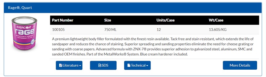

The link there is appreciated but as I mentioned Rage 105 IS recommended for SMC by Evercoat (I should have said 'on their website.') Here is the product summary:
Gall757 JUN 27, 09:13 AM
How confusing.
"Rage Gold also contains ZNX-7® for adhesion to galvanized steel and aluminum."
Apparently they figured out an additive that makes the stuff work better, but they are not consistent with their descriptions. Considering the risk of re-doing a paint job, I would look for something that was made for SMC and said so on the label. When you do patch the SMC make sure it is dry as a bone before you start. (should be easy to do in Southern California... )
