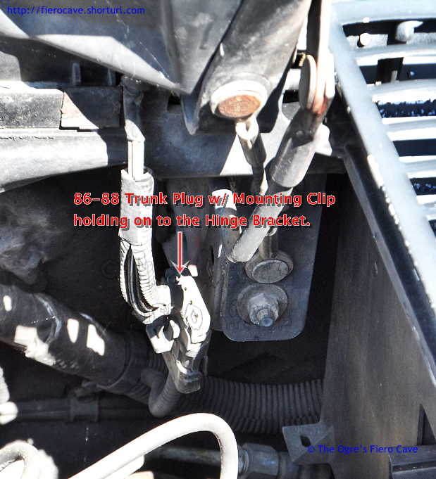

86-88 trunk plugs should have a clip that uses 1 hole in side of hinge bracket to keep plug etc far away from exhaust.
Factory clip may get wreck but need to tie wrap to same part.
86-88 trunk was 3 or 4 wires to the latch from that plug.
3 wires for all use w/ the ajar switch on the latch. (Also turns on Trunk light if you have this option.)
4th wire is only present w/ PT option.
84-85 has a single wire in the lid only when have the PT option.
Make sure the single "pin" plug is far away from the exhaust. Maybe coat the pin w/ bulb or brake grease too since isn't a Weather Pack plug. I think This contact removes same others like my Cave, Defect & Connection notes w/ small wire/screwdriver so can clean etc easy.
PT solenoid gets ground thru the latch and loop when closed. Make sure latch is tight when closed or have iffy/no PT ground.
