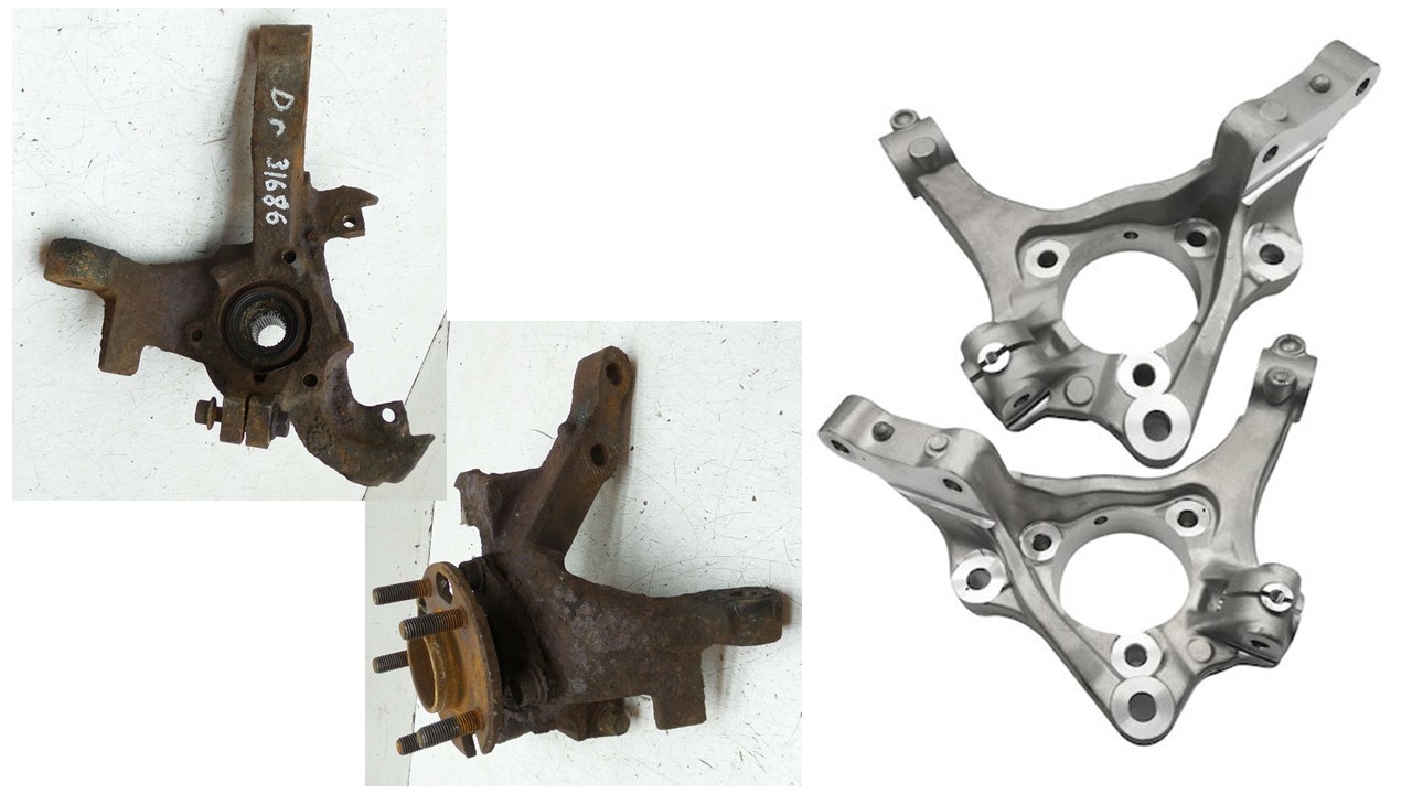

I am working on solutions for the 88 front and back, but haven't looked at anything 84-87 (and probably won't). Generally speaking, for an upright to be compatible, all the following needs to be within an acceptable range.
Bolt pattern spacing (and size of the holes) at the strut Angle of bolt pattern from spindle to strut Tie rod placement (elevation) Tie rod placement (location - on top of steer arm or below) Tie rod distance from wheel bearing (length of steering arm) Steering arm angle from wheel bearing center-line
All of these come into play when you are trying to fit a new spindle under the car, keep the camber in the adjustable range, keep bump steer to a minimum, and not mess up ackerman angle (all these aluminum spindles are rear steer and we are making them front steer (if used in the Fiero front).
The other myth is that you will end up with something lighter... depending on caliper and rotor selection that likely won't be the case.
My motivation with the 88s is strictly to get larger wheel bearings (front and rear) for increased strength and stronger CVs to support my Turbo AWD LS4/F40 project.
Here is an overlay of the W-body spindle with the 88 rear spindle...

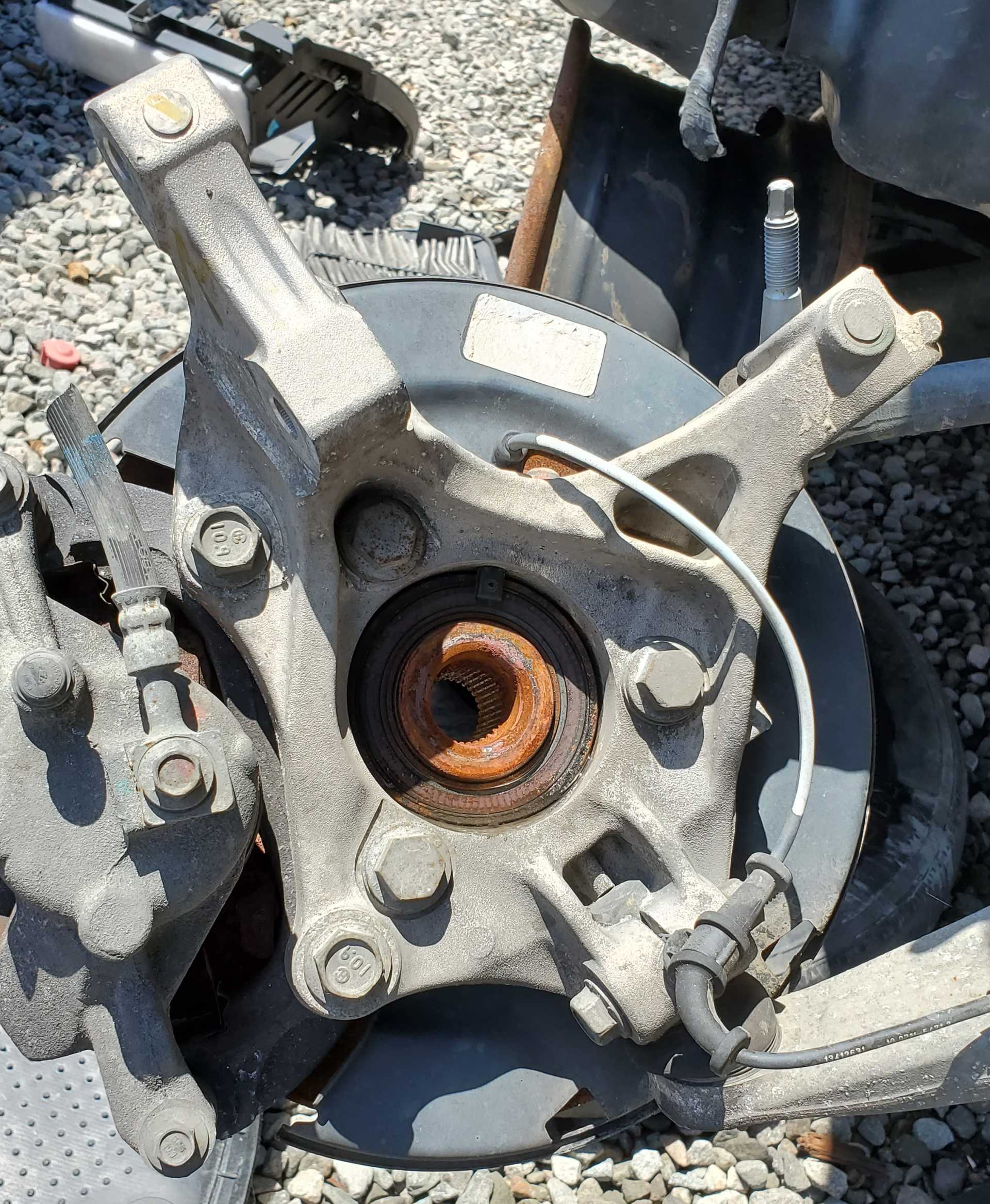

Well after I posted the question, I went to Pick n Pull and grabbed a set of spindle units off the 2016 Buick Regal that I pulled the LTG motor from. I figure that even if they don't work for what I'm asking about, i'll still have a use for them down the road.
and the cool thing is that these have a 5x120 bolt pattern.

also, while I was walking around i found a 2013 Chevy Sonic and grabbed some pics of the spindles to see if they would also be a good candidate.
Rob
