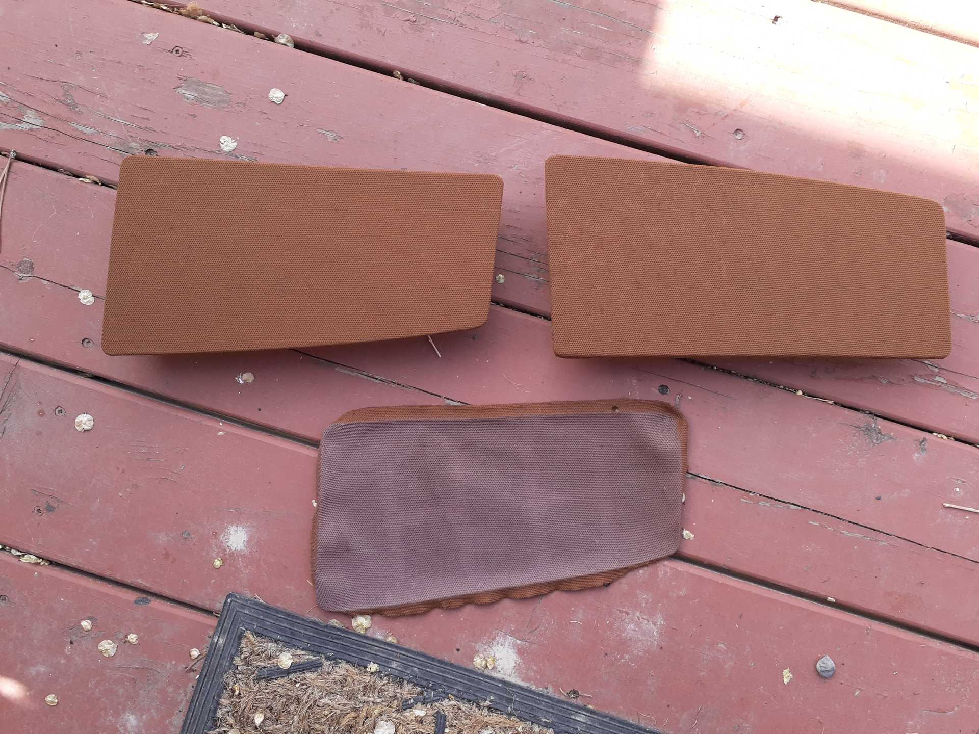

I used the only spray adhesive they sell at Harbor Frieght and followed the instructions Rodney provides. However, I found it easier to trim the excess with a new razor blade rather than the heat knife, with exception of where the material bunches at the corners, there the head knife was helpful in cutting through multiple layers without tugging the fabric too much.
