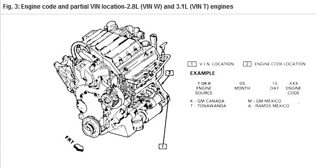

I have an engine that was removed from a Fiero. It's remanufactured, but the tag doesn't give a company name.
The engine has a crankshaft sensor and a knock sensor in the right side of the block. It doesn't have the webbing and "F" of the 3.4 V6. The block sides are smooth and has a "T" casting where we would usually find the "F".
I need to get injectors quickly for an install. I don't know what the displacement and hp is.

When I get back to the shop tomorrow, I'm going to look for other numbers on the block.

We could find no numbers on the block. Castings only showed GM and T.
I noticed it had a weighted flywheel so with the crankshaft sensor and knock sensor still being present on the block I opted to pull the pan. It has a neutral balanced flywheel with a weighted flywheel. We'll be pulling the rear main to plasti-gauge it.

As best as I've been able to determine, the engine is a 3.1 from a W body FWD vehicle. Those were used in the late '80s and early '90s.
