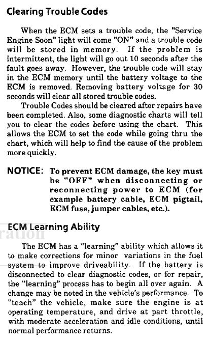

Oops. I pulled this from Factory Service Manual.
You may want to try it again.
Check wiring for good connections.
Unplug, replug IAC and TPS connectors a couple of times.
How fresh is the gas?
[This message has been edited by fierosound (edited 05-08-2020).]
