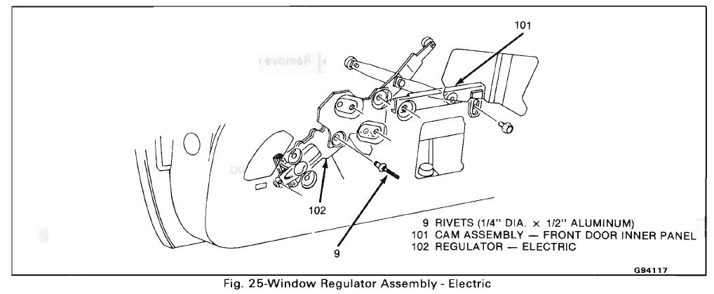

In Factory Service Manual - Section - Doors
Replaced all motors in both my cars last year.
Window motor and almost everything on door is 1/4" x 1/2" aluminum. You'll need about 12 per door.

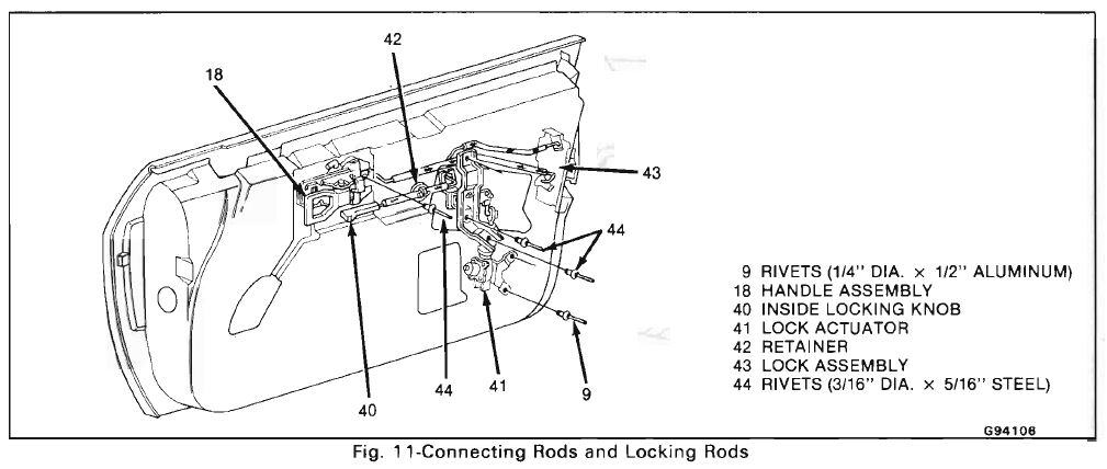

Also a couple of smaller ones, for door lock rod bracket.

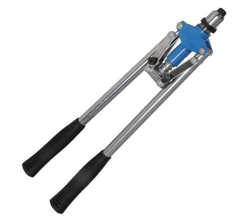

You'll need something like this to install them.
