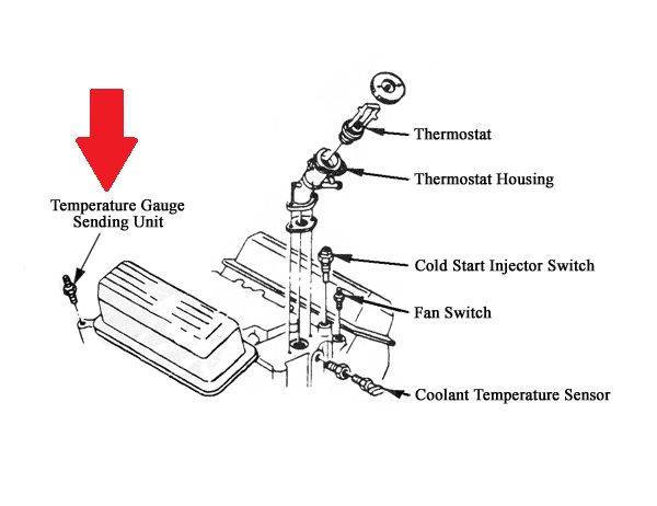

Well... you say you changed the computer sensor (for ECM), but temp gauge still doesn't work. There's your problem.
You need to replace the temp GAUGE sending unit. ACDELCO part number 2134547 or equivalent. Has the plug in connector been butchered? Pics http://www.fiero.nl/cgi-bin...ad=20130314-2-117673

You’re right, I just ordered the other sensor hopefully that does the trick I had no clue these engines had multiple sensors. I’ll send pictures just to make sure.
