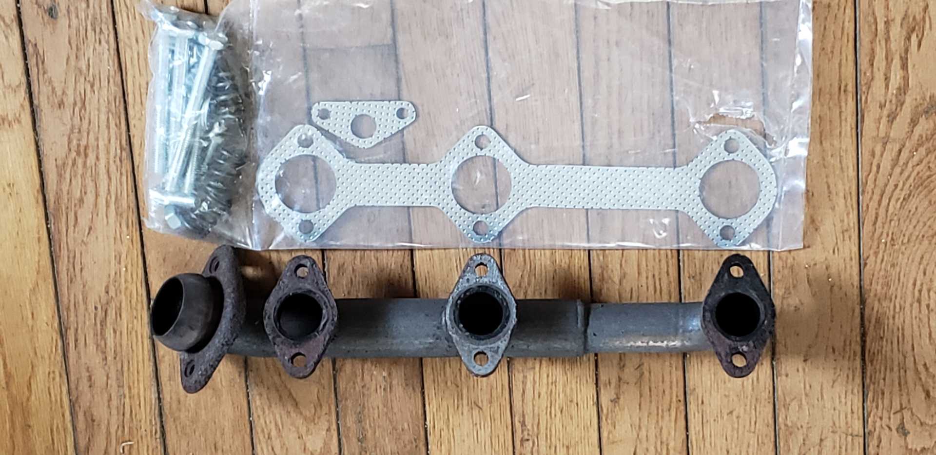

pontiacfierokid1985 APR 25, 09:35 PM
Ok so question need to do exhaust manifold gaskets on my 2.8 and was wondering if the 3.4 Camaro exhaust manifold gasket will work on the 2.8. I heard that all external fiero stuff will bolt to the 3.4 so I feel like I’m answering my own question here. Just looking to hear your confirmation on this. Fiero 2.8 exhaust gaskets are 20.00 dollars on rock auto while the 3.4 Camaro are only 4.00 bucks so why not take the budget route.

olejoedad APR 26, 12:18 AM
As the 2.8 and the 3.4 use the same heads......why would the 3.4 gaskets (or the VW) not fit?
Short answer...yes, they will fit the 3.4.
