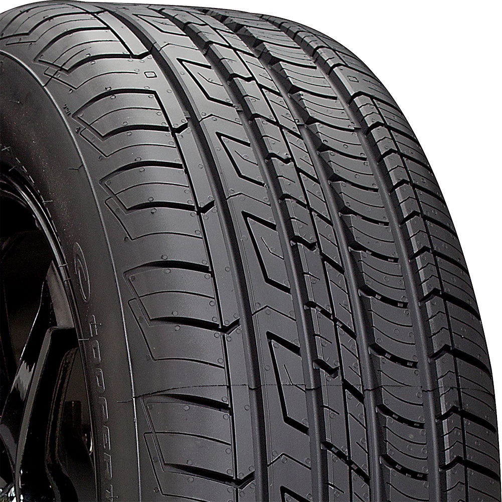

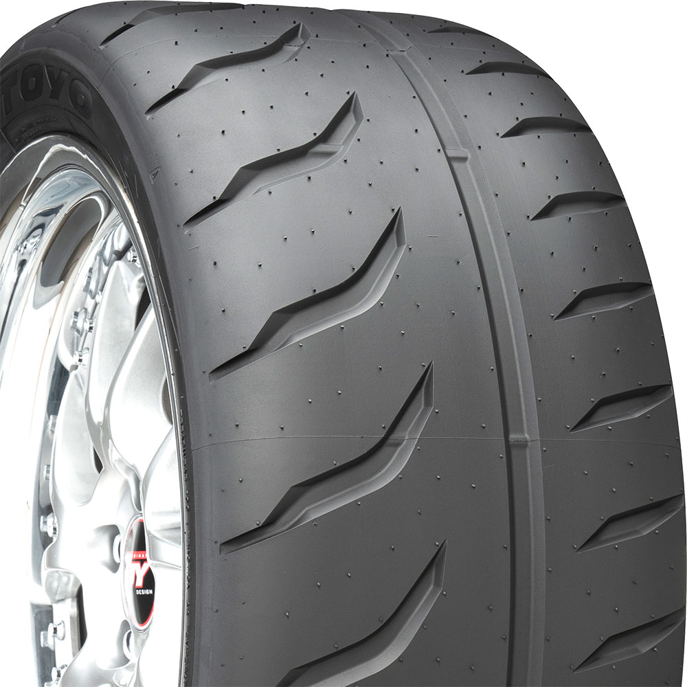

So the tires on the GT I bought this past week are 8 years old and showing all the warning signs. I'm committed to the stock wheels because I love the way they look and the car is a low mileage (57k) relatively unmolested example. Only real upgrades are a performance clutch kit, short throw shifter, and KYB suspension. Pretty much I've narrowed it to 2 choices:
Cooper CS5 Ultra Touring (retaining stock sizing) at $90/tire
Toyo Proxes R888R (would have to move to 235/50s for the rear and 225/50s for the front, both are about 3.5% smaller than stock diameter) at about $170/tire
I'm not too worried about the cost difference, and I'm not going to drive when there is any potential for snow. The Coopers are a "performance" all-season while the Toyos are a DOT rated track tire. My main question is, are the Toyos overkill? Does the car need substantially more power and braking ability to really take advantage of them? I suppose the cornering would still benefit without modification.
I guess I don't see a reason for the extra cost and somewhat compromised performance in the rain and cooler weather if the car is not really benefitting otherwise. Thanks for the input!

I have those Cooper CS5s on my daily driver 2006 Subaru Impreza for a few years now and they have been very good to me in all conditions. When my Firestones on my 88 wear out I would put them on my Fiero with no hesitation. ------------------ "Discord" Red 1988 GT under restoration!

Hello Modesto, I have 2 stock '88 GTs and went with the Coopers but for the rear I upsized to 225 from the 215s. I like a bit of extra rear grip. Happy with the Coopers for a year now. I think the Toyo's are overkill. JMHO...Enjoy the '88
APR 11, 11:52 AM
We've run the Cooper's for a long time.
215/60/15 front, 225/60/15 rear.
I think the upsizing is beneficial to the handling.

Wow, those are polar opposites. You're comparing an all-season tire to a "track only" tire. Do you race it... like, on a race track? If not, then the Toyos will be a waste of money. IMO you'd be better off with some high-performance summer tires.
Regarding tire sizing: A tire with good tread compound and a well-engineered tread pattern in the stock tire size will out-perform a crappy tire that's wider. Just a thought.

I use exactly those Toyo Proxes tyres on my car in exactly the same sizes. Yes the ride is harsh (suspension mods as well). Yes you can nail those corners at high speed without scrubing the front tyres or losing the back end (spinning out), in the dry. No, you can't take the car out on a wet day! Not unless you like wheel spinning burnouts at each gear change and losing it totally on the same corner that you did so well at the day before when the sun was out!!
Saying that, I wouldn't put cheap "normal" tyres on my car any more. I like the precise feel that the Toyo's give.
