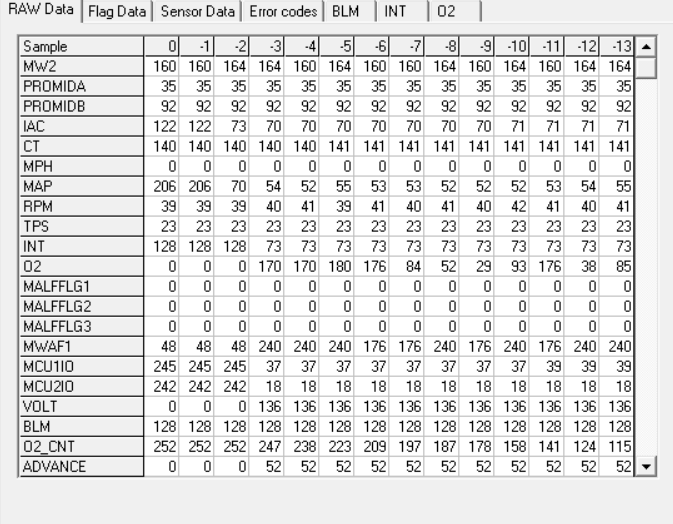

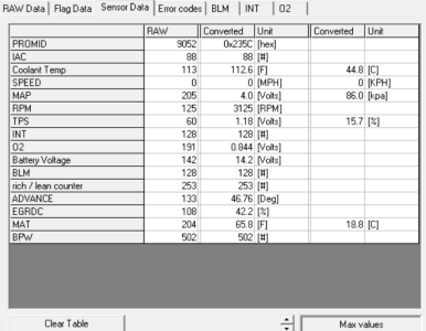

So I picked up an aldl cable to get my readings, check for codes, senors working ect. Now all I am trying to do is compare these to a fiero thats not running poorly like mine(poor acceleration under load) and see if it will help lead me to the right thing I need to fix or at least a general direction. So I came to the place with all the smart people because I couldn't find anything online, in my user manual, repair manual, ect. My car is an 85gt 2.8l .

Hard to say without more context, but what's with the single low oxygen sensor reading, and the coolant temperature never changed from very cold? How long was the car on? First few readings appear to be before the car was started, and with it just sitting there in park/neutral?

Ya so first reading was car at idle and then later readings were reving car

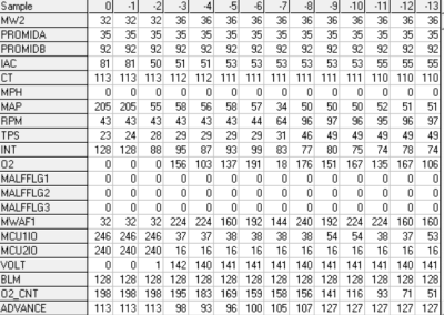

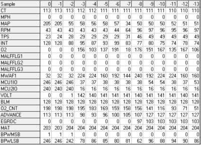

Patrick's graph showed coolant temp going from 87 to 208. Your coolant temp is going from 113 to 110. Something is not right there.

 This was taking the car for a drive after it had warmed up for a while

I don't see the Manifold Air Temperature readings at all, and the maximum Coolant Temperature of 141°F is way too cold.
Do you actually have a thermostat installed? If you do, what temperature is it rated at? Should be 195°F.[This message has been edited by Patrick (edited 04-03-2020).]
