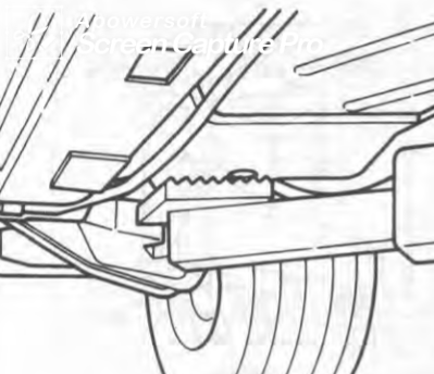

I just got my new Quickjack and want to use it on my 87'Fiero. The rear lift points are fine. However, I am confused about the location of the front ones. The colored diagram that I have seen in repair manuals shows garage lift points that differ from the Factory Service Manual(page 18). The Factory manual shows small humps with a hole in the middle as the lift points(see image below). I am confused- anyone have an opinion? Thanks-Rolf

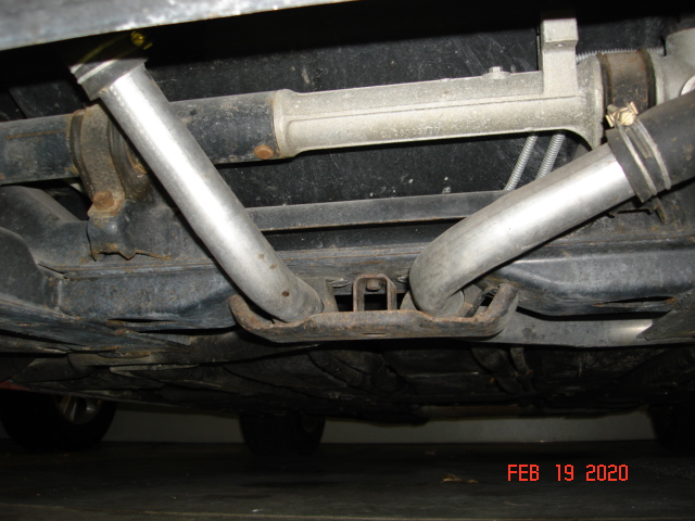

Thanks, Ogre. The green square on your diagram, in the center of the front wheels; this is the area I'm asking about (photo attached), with the bracket covering the coolant tubes. It's okay to use a floor jack here? I'm concerned that the bracket would collapse, possibly compressing the coolant tubes.

If that's rust rotten then could crush 88 coolant pipes jack there. Seems solid to jack since is also the "rock shield" to prevent crushing pipes on the road driving over crap. Just watch it for damage. More so w/ common floor jacks sold to DIY market. Many have small heads that often slip off or crush things.

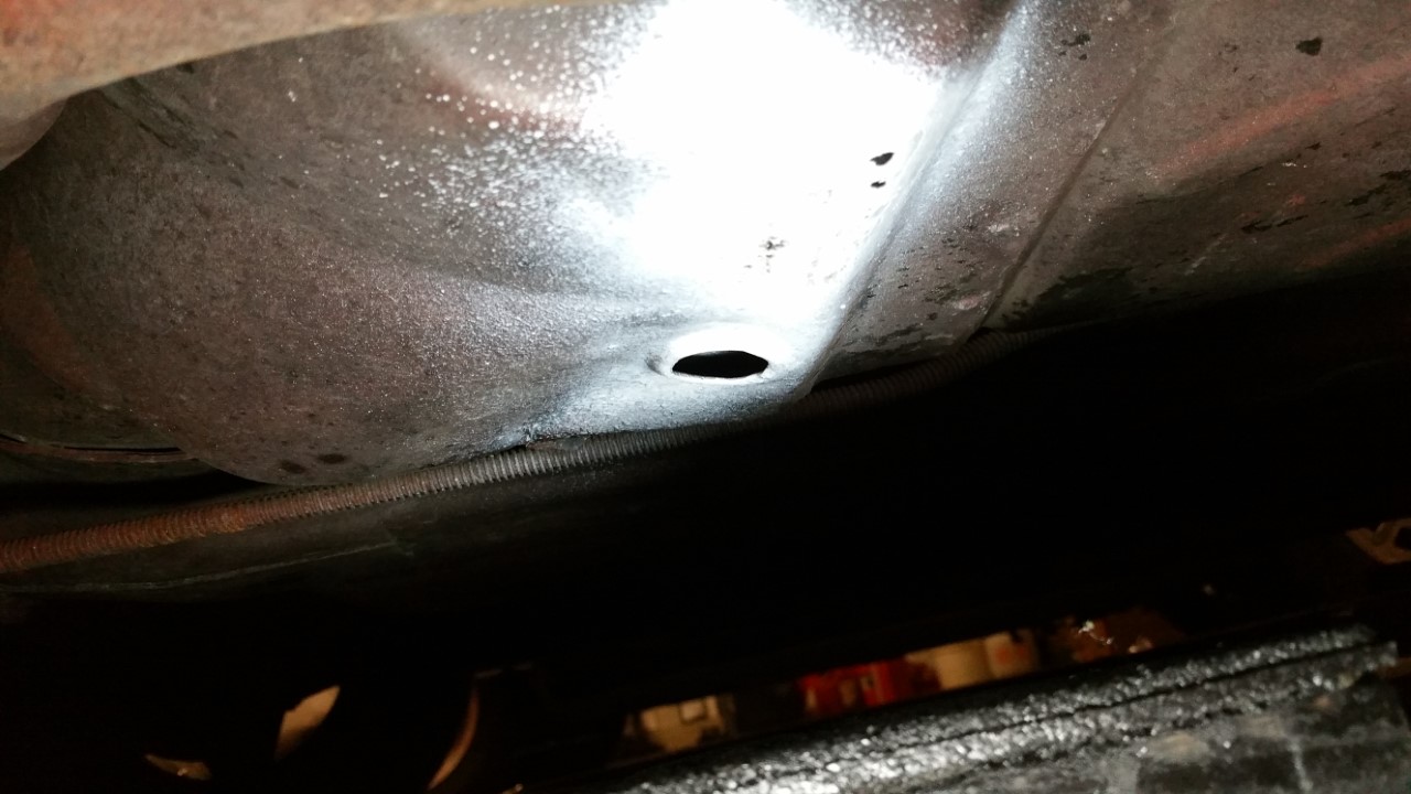

The jack point is further inboard beyond the spring wound tube... which I guess is your clutch hydraulic line, since there's only one (which means it's not transmission cooler)[This message has been edited by Will (edited 02-20-2020).]

I finally found the factory manual's lift point - It is where the hole in the sheet metal is-it shows a 2 post lift and the saddle contacting the lift point- Opinions?

This is the lift point:

Makes sense- it just looked like the saddle was on the hump by the hole- thanks
