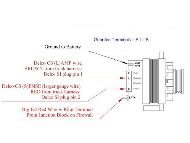

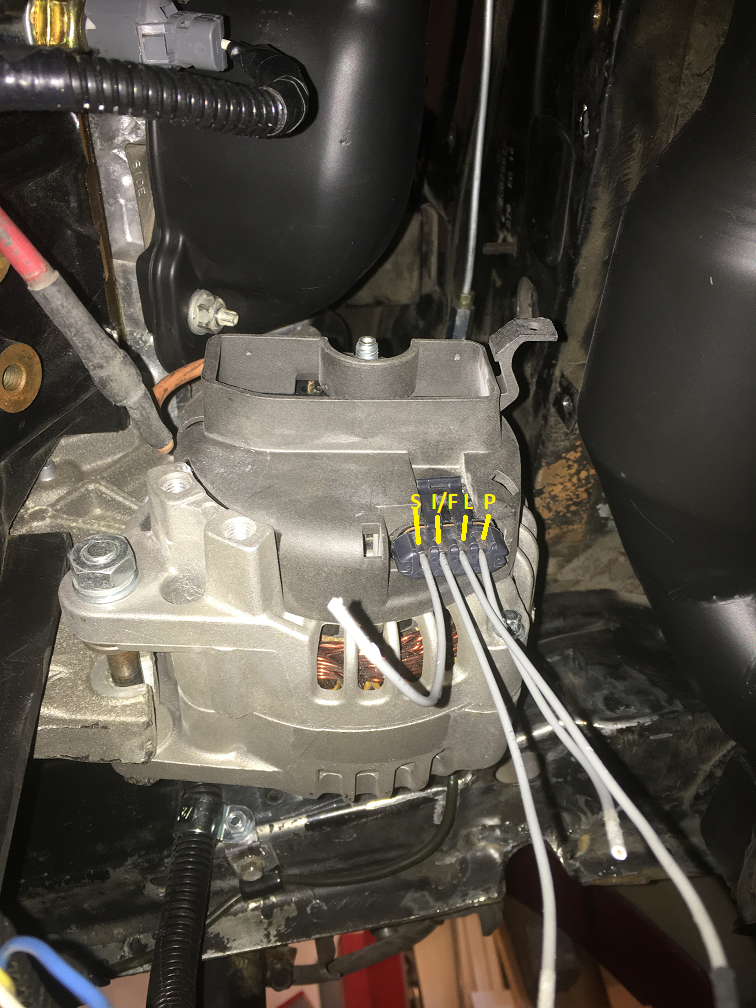

A question for all you wiring guys. I don't seem to have charging working so took a pic of the wiring on the alt and then a pic from the net. I was told by someone that the charge light on the dash comes from L and the switched power on to F (which is also I in some pics). I took a pic of my wiring and labeled the alternator plug the way THINK it is supposed to be. Hard to tell really as I am looking up to the plug on the alt but not sure if the image would translate the way I have labeled it.
Looking at several pics online, I am pretty sure I have the power wired up wrong. I added an image and it says to put the signal power to S not F/I. Does that sound right to everyone that knows more about wiring than me...?
Thanks Don
My alternator wiring now
CS 130 version of wiring I found on line. typical hookup frmo what I can tell.
 [This message has been edited by 355Fiero (edited 04-16-2020).]
