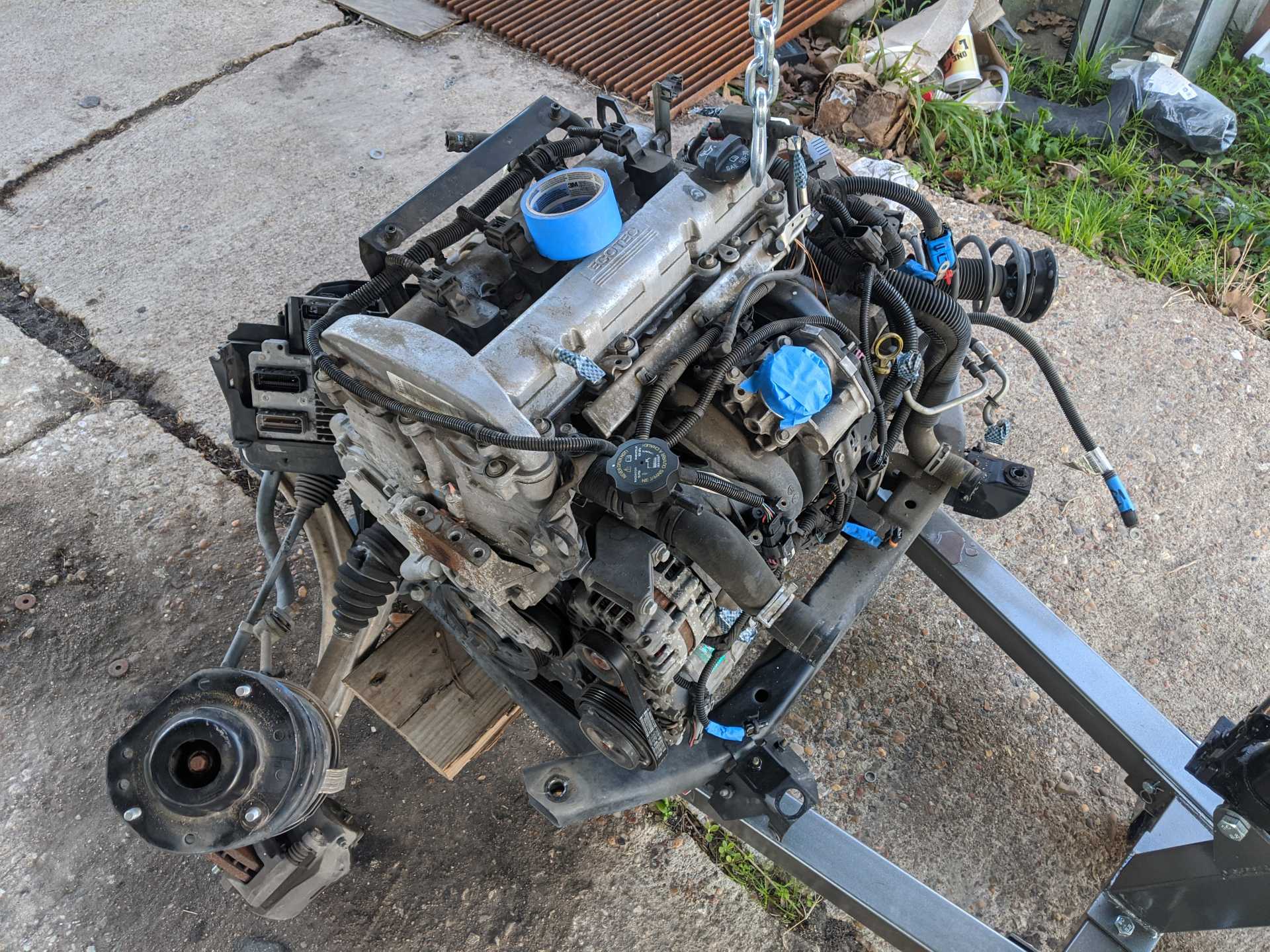

Hello, I'm In the beginning of a 2.2 Ecotec swap into my 88 formula. Got the engine for free along with the rest of the car (08 HHR) and plan on using as much of the stock parts as possible so this swap can be done by others. I'll probably be going pretty slow but I'm going to make sure to keep this updated as I go.
I love this car I really just want something that's a good driver's car and I think this should accomplish that.
Here is a picture of the engine that I pulled yesterday!
Next will be to remove the cradle from the fiero and start comparing stuff.

Made any progress? I'm doing the same thing with a 2.2 from a 08 cobalt
Its funny, because my motor I pulled a couple days ago also has a roll of blue tape on it, and my driveway is in similar condition. lol
