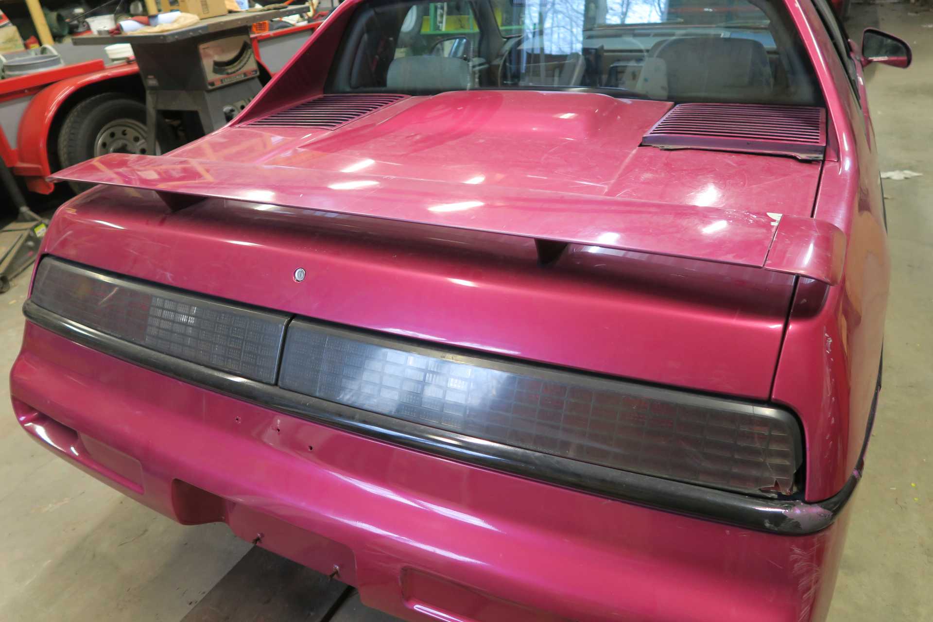

Although mine is a base model, it has a spoiler (and incredibly ugly purple/pink paint). The spoiler is actually three pieces, with the side downturned tips bolted to a straight center piece. Is this an aftermarket item? It's not a great looking piece.
Post a picture or two. It's easy to do here now.

Here are some photos of the spoiler. The more I look at it, the less I like it. Anyway, minor compared to the total project.
How about that for a color? I'm glad I will be repainting it anyway.

Looks like some kind of Trans Am spoiler?
Actually, I kind of like the color.

I was going to say it looks like a badly faded stock color but then I noticed the over spray on the grills. Looks like it took a hit to the right rear based on how the right grill is lying relative to the bumper. Pull the panels rear and take a closer look so you can assess any upper frame rail rust/damage as well which is usually well hidden by the bodywork. Oh, and welcome to the madness...!------------------ Anything I might say is probably worth what you paid for it, so treat it accordingly!

The right grille is off because the battery is shot and I have to put the charger on it to start it. As nearly as I can tell the car was originally blue. I won't be sure until I get it apart, but the body damage seems to be limited to minor scrapes. The frame looks good from underneath, but I know I have to get it apart to be sure.
