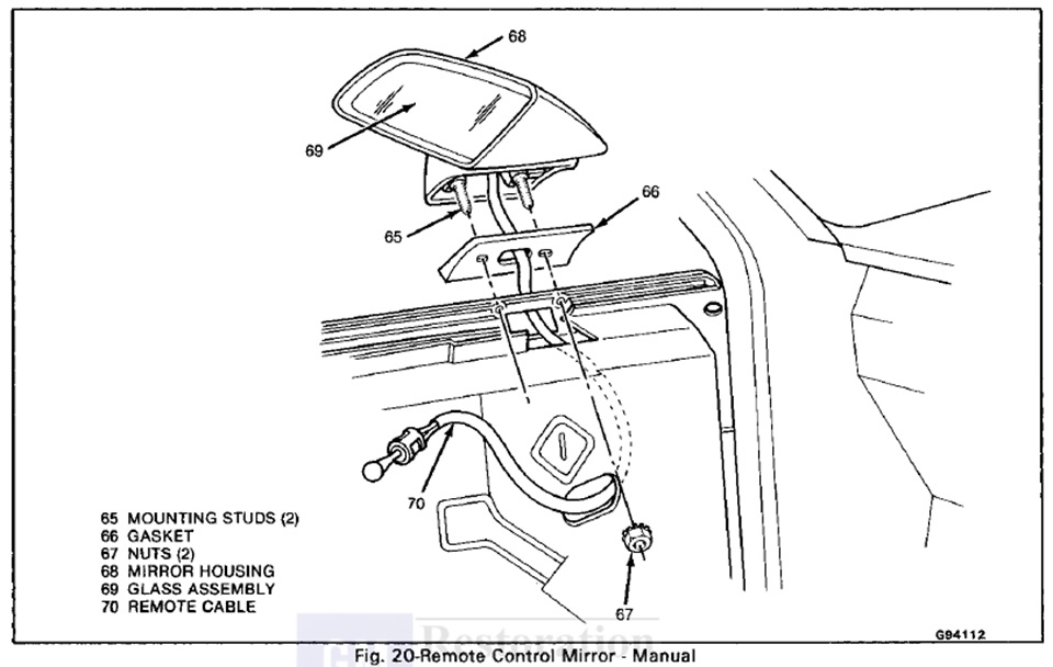

Where do you start to removed the inner door panel on the driver side? I need to get to the mounting bolts for the side mirror.
Preferably with as little damage as possible. Are the infamous plastic rivets used? I imagine they are dried and are brittle. I dont readily see any bolts or screws.

Door panel off and window down - YES...
Remove 2 nuts on mirror studs (power or manual)

You have to remove the inner window seal and front seal, then you will have access to the nuts. The studs from the mirror run thru the outer window seal framework. Just take your time removing the nuts.

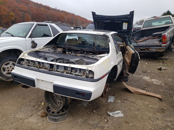

Hey- If you need to fix/replace your side mirror, I would think replacement would be better than trying to fix it; Just checked on "Row 52" and there is an 84 Fiero in Elmira, NY in "Horseheads Pick-a-part"....You could also try in the mall and see if someone has a extra they could sell you, or Fiero Factory in AL.......Also, I believe other GM vehicles use that same mirror.....
Row 52 usually has pics of the car so you can see where it was damaged (Basically)
