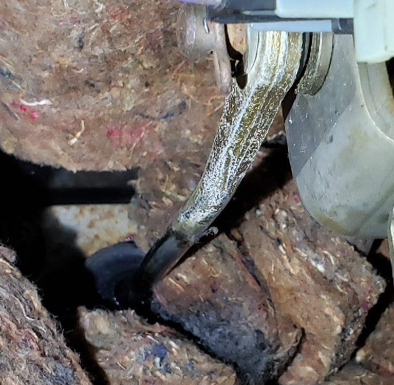

Edit: I just noticed that my clutch pedal is lower than my brake pedal. I guess that means I need a new master cylinder.[This message has been edited by Doug85GT (edited 07-20-2019).]

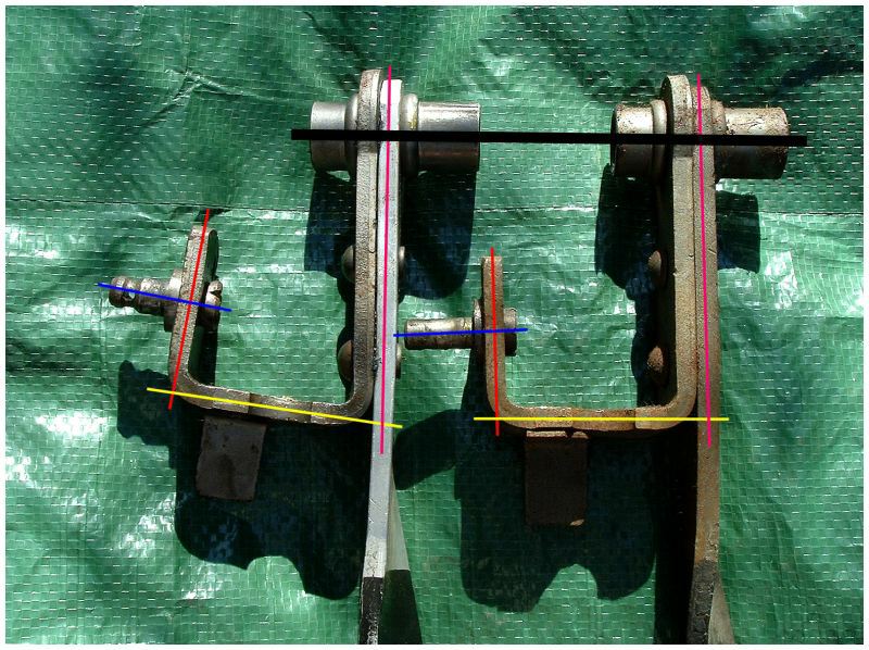

quote | Originally posted by Doug85GT:
It usually indicates that either the banjo and/or the clutch pedal is bent.

JUL 21, 10:52 AM
quote | Originally posted by AsaBergman:
I'm not sure but I believe by 88 they came with the steel pedals?
Nothing is unbendable.

Doug85GT
JUL 21, 12:00 PM
The banjo rod is bent and the master cylinder is leaking.
